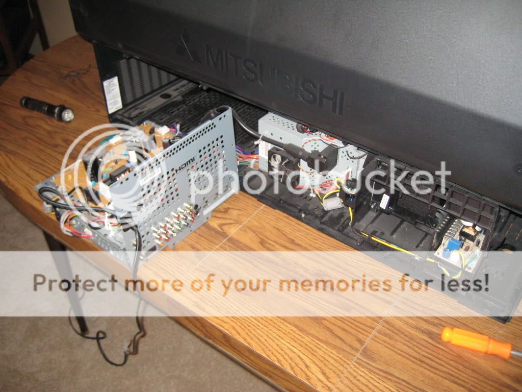

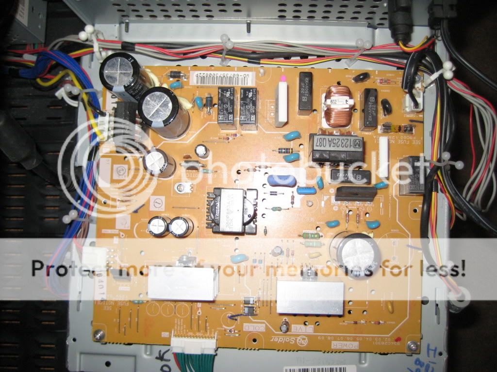

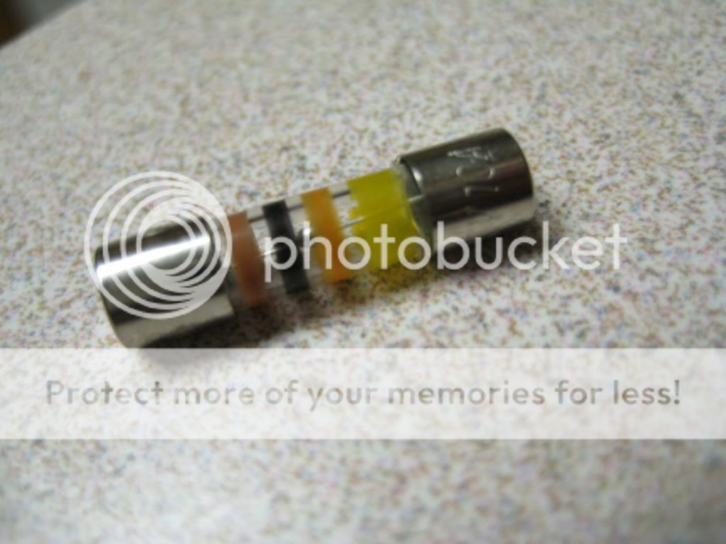

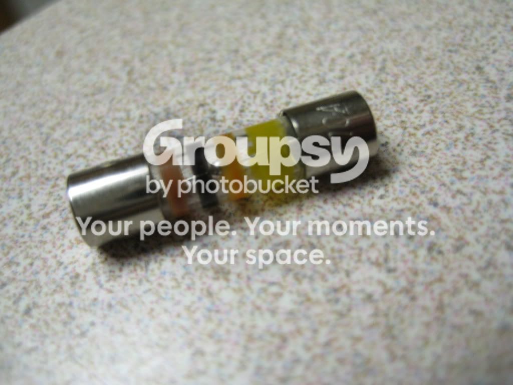

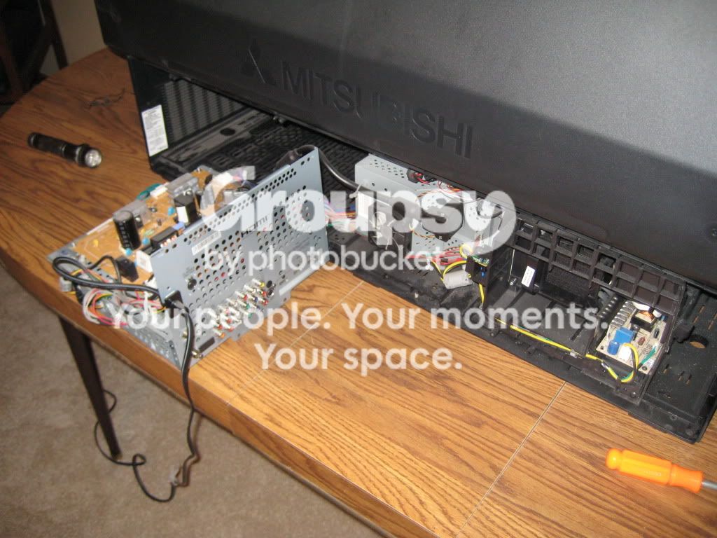

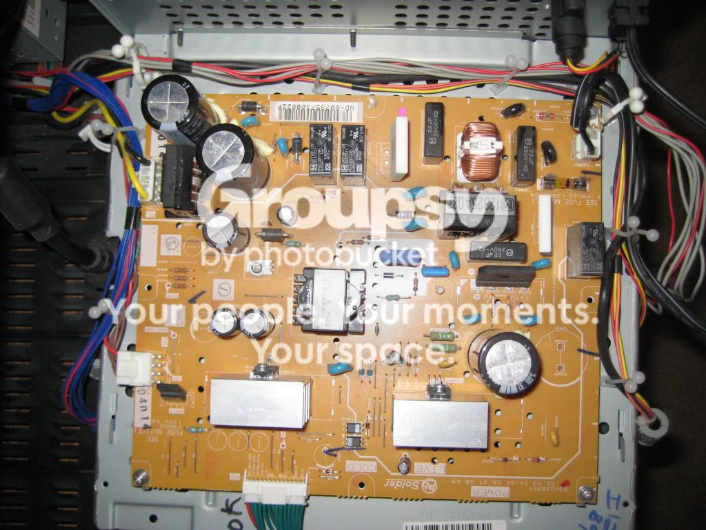

So I took the back cover of the unit and found the fuse on the board. Pulled it out and tested continuity. It tested fine. I looked over the board for signs of caps that may have gotten bad or burned board areas, but could find nothing that was readily apparent.
I plugged the unit in to the power strip and could hear the board relay click. And click again when I pulled the power cord from the power strip.
Not sure what to look at next, what to test, or where to go from here.
Link to Service Manual: http://forums.audioholics.com/forums/showthread.php?t=75259
Pictures of the Board, Fuse (from that board), and rear of the unit

So today I pulled the Power Board off the chassis. I tested the 3 fuses that other fuses on the board. They all tested good. I then looked at the Main Board, tested both fuses and they were good.
A friend suggested that I check the two MOV (black discs in the upper right corner of the powerboard pic I had in my earlier post) to see if they are shorted or open. I'm not positive on the best way to do that, any help would be appreciated. He also suggested that I test the diodes in the upper right corner too. Hoping someone can provide insite on how to do this as well.
