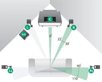

It is possible that the asymmetric walls up front is causing issues with room reflections. Most likely, you are compensating for the right wall by boosting the left levels. That will be a good imaging killer since higher frequencies will reflect/be compensated for while mids and lower frequencies will be overcompensated.
Maybe you can try to move the setup into something like this and see if it helps? You can also try keeping the sub in the gap behind the TV stand.
Also, I would recommend lowering the TV a little by moving the amp and BDP to where the CD rack and sub are currently located. And, the Marantz should not be covered up by the player. Both, the amp and player may fail due to heat build up. I recommend stacking the PS3 over BDP over the CD rack, next to the PC and having the Marantz by itself on the far right. This will also allow you to move the center to the middle of the rack, creating a better match with the L-R phantom center.

Alright, so I moved the TV down, the BDP over, and the PS3 down. I liked your idea of moving the setup into a corner, but unfortunately the right side of where that corner setup would be blocks the main heating vent, so that's out. :(
I also ordered some panels from ATS Acoustics, and I think that helped the imaging a lot.
Infinity PS-8 subwoofer is gone, hello Emotiva Ultra 12 sub that was on clearance for $349 with free shipping!
