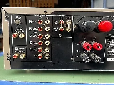

No bass/treble from Yamaha amp
What kind of devices do you have connected to the unit? How is each device connected to the Yamaha?
Assuming the Yamaha is fully functional, tone controls will not work in a few instances. If the Pure Direct function is ON, tone controls will be bypassed for every input source device.
If there is only a single external device in the system and it is connected to the CD/DVD input ports, turning the CD/DVD DIRECT AMP function ON will bypass tone controls.
If either the Pure Direct or CD/DVD DIRECT AMP function is ON, the PRE OUT/MAIN IN ports are bypassed.
The TAPE MONITOR feature of some units is not present here to use with a connected equalizer. So, an equalizer used here would have to be connected to the PRE OUT/MAIN IN ports. The PURE DIRECT AND CD/DVD DIRECT AMP functions bypass the PRE OUT/MAIN IN ports and must be turned OFF when using an equalizer.
Additionally, when using an external processor or even an older TV with analog output ports connected to the MAIN IN ports, all control functions will be bypassed and volume and any tone settings will be made by the external device.
As always, incomplete system information means anybody attempting to help will be shooting in the dark. It is essential for posters to provide any and all information concerning each and every device as well as each and every setting in a system.

Basically, if PURE DIRECT and CD/DVD DIRECT functions are OFF and the jumpers are connected from the PRE OUT to the MAIN IN, the tone controls should work for any directly connected devices. If not, the unit is defective in some way.

Wouldn't tone controls or an EQ have to work if it was inserted between the pre/main connections? At that point, the amp isn't going to have any effect on what goes to the power amp/external amp. I've had a couple of amps and receivers that didn't sound good at all, but the only Yamaha problem I've ever really even seen/heard that wasn't outright failure related is my AVR had to be reset a lot or the surrounds would barely have any output. It was the reason I retired it at age 11 or so. That and the HDMI issues related to it's age at that point.
