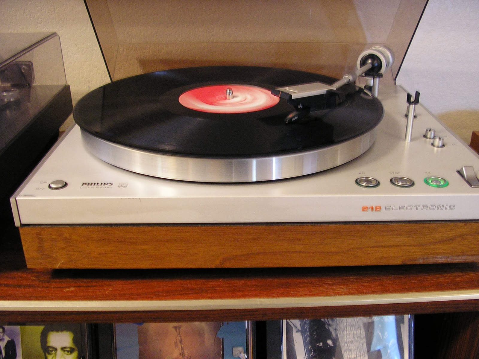

I have just newly retired and want to return to using my "stereo" system. [That is what I grew up calling it].
I have a Denon AVR 1600 Reciever, and a Phillips 212 Electronic Turntable, going to a Paradigm power sub, and 4 bookshelf type speakers.
I want to play my 10 to 40 year old vinyl records, that are in fair condition. They were played on the Phillips turntable, so they are OK, but certainly not in pristine condition from being played on a $2000 turntable.
I have a Grado cartridge on my turntable, probably a decade old, that never gave me enough volume, it seems to be about half of a CD player volume. I added a TC-750 Professional Moving Magnetic Pre-amp in line between the turntable and the amp, but it did not help a great deal. If I get near any increased volume for my old rocker LPs, I get considerable low hum.
The Denon says the phono input sensitivity is 2.5mV/47 k ohms
Would anyone have new cartridge recommendation that would give me more volume? I do not want to spend a ton on a non-essential item just yet. Is $100 or less even in the realm of a solution to this issue. I have no clue as I have been out of this so long. Many thanks.

Hey folks in answer to several thoughts:
Phono pre-amp was going into the VCR, and I just tried the phono into the phono input, without much loss of volume, so I just took the pre-amp out of the system-maybe less source of hum.
I googled and checked the cartridge wiring, and this seems to be correct.
I rechecked the ground wire from the phono to the received.
Here are results, my volume reads from -50 to positive 13.
Playing a new LP, at volume -10 it is just a bit below a sitting position, long term listening level. I could have a conversation with you in the seat beside me. Hum is noticeable at -10 between tracks. At +10 thru +13 the hums is very loud [when the needle has been raised] .
Playing McMurtrys Candyland at -10 on the CD player it is unpleasantly loud, no conversation, but also ... no hum. With CD player on, and not playing, I get a tiny bit of hum at +10 thru +13, but at this volume it would hurt my ears and probably damage my speakers.
So, not sure how to proceed.
I will take the advice above and try to see if the turntable wiring is the problem. I wil take the turntable to a local audio store to check the output and the hum, and based on these results move to the next option, a new cartridge.
Any additional thoughts welcome. Thank you all for your suggestions.

I was not familiar with that turntable. It is almost certainly the problem. It is early 70s vintage. It is not direct drive, but the motor is driven by an oscillating servo circuit, with electronic speed control. Unfortunately this is not a fully manual turntable and there is a lot of complex switching in the connection from the cartridge to your receiver. There are enormous possibilities for major problems. At that date this technology was in its infancy and turntables of this date from that period are very trouble prone. This one I have found is no exception.
There were few sold and most in Europe. This is not the sort of thing the average local electronic shop is going to fix.
Your last post leads me to suspect that the power supply has excess electromagnetic radiation that is being picked up by the cartridge. Your problem is very unlikely indeed to be a cartridge problem.
The bottom line is that more likely than not restoring your turntable is going to be expensive and a labor of love.
In your situation since you are not technically inclined, my advice to you is this.
Put the turntable up for sale on eBay for parts or repair. Do not destroy it. There will be an enthusiast for this unit who has the interest and ability to restore it, or cannibalize it to restore one he already has.
I think you will be able to buy a good new or used belt drive turntable for less money than trying to restore that one. That would be assuming you can find someone in the US to take the job on. Most enthusiasts not surprisingly are in Holland.

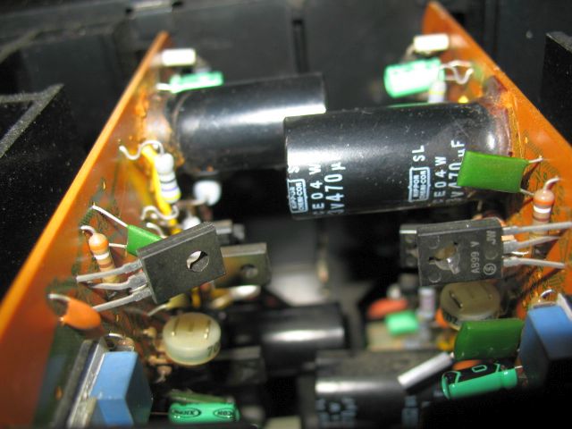

What is your old Sansui Power amp? Is it an integrated or separate? You should pop the top and look at it. Likely, there is an amber/brown residue and corrosion around the bottoms of the capacitors. Check this photo at the bottom of the black cylinders for what to look for (BTW, this AU-717 still worked and sounded very nice, despite the leakage/corrosion; however, I'm sure it would have revealed weakness if pushed hard):
They made some very capable amps back in the 70's and early 80's; but took a nose-dive in quality thereafter. Look up your amp on ebay and see what the history is on it (make sure the amps were functional as many are inoperative and sold for parts, with a significant depreciation in value).
I don't know turntables anymore (I still have my Thorens from the early '80's), but ask for suggestions and state your budget. I would think you could retain your Grado cartridge and save money, it sounds as if it is in good condition.

He has a newer Denon AVR. The cap problem if there is one will be in the power supply of the turntable. If there is a cap problem I doubt his issues will end there.
I was commenting on the Sansui he has in his closet:
...and I may indeed just replace it. If I do, I will learn eBay and just sell it and the very old Sansui power amp stuck away in a closet.
Thanks, TSL Guy
This was a common issue with the Sansui's from this period; however, there are still plenty of people who are willing to pay a good price for a working unit and clean replace these capacitors!
