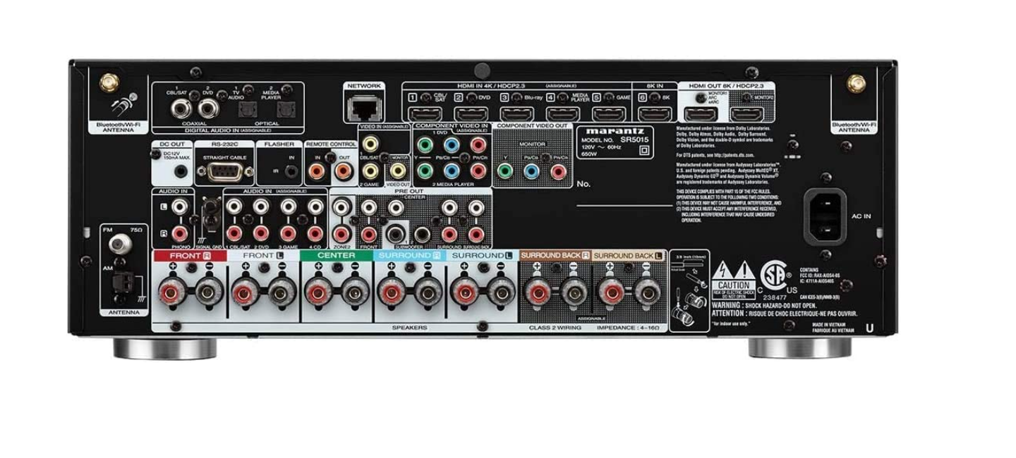

Thank you for the suggestion. The Marantz SR5** does have preouts. Unless I am mistaken. Here is a picture of the back. I'll take a look at both the Denon 3700 and Marantz to understand more. Thank you!
I stand corrected! I always thought of the 5 series as having no preouts, so thanks for the correction. In that case, if room correction is not a major concern the SR5014-15 look like they have everything else you need. If the difference in price is significant I think the 5014 is still plenty current.
Altho it has pre-outs, it has the lesser version of Audyssey vs the 3xxx series from Denon (which has XT32 instead of just XT as in the 5014/5).
I see this under sensitivity for the Mc7106 1V, (2.5V with Level control at center detent) so the Marantz should be fine in this regard.
I originally thought the same, maybe it's older 5 series stuff?
We got Mandela'd. :p
He brought up preout voltage too. I know that can be a factor with some amps and receivers.
Doubt the Marantz will have any trouble mustering 1V out on the pre-outs for the Mc7106 and even if he did it at least it has some adjustable gain....
