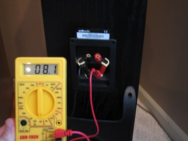

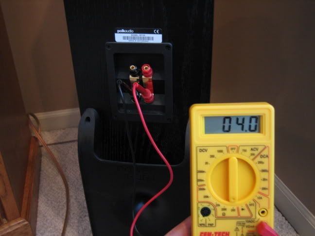

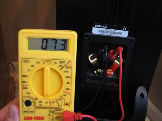

Please explain the following then. What's the difference bridging two 8 ohm speakers as opposed to how these are connected? Are you saying the receiver sees no difference in resistance when I'm running the top only, as opposed to the entire setup strapped? How can that be?
I've emailed Polk on this issue (for the second time).
top:
bottom:
both - strapped:
