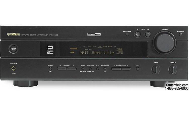

I assume your AVR is a Yamaha HTR-5550. This model:
It only has three audio output connections. Optical, VCR RCA Out, and the headphone jack on the front. None of the audio connections are volume controlled except the headphone jack. In my experience, Bluetooth is far more problematic than a wired connection, but it does allow you to move some portable speakers around, which can be nice if that's one of the goals. They can suffer from pairing issues, which can be a headache. Volume, as I said, may only be controllable on the speaker itself if the AVR isn't using a volume controlled output.
I'm not sure what components are beyond those you listed. It would typically be a couple of stereo speakers hooked up directly to the Yamaha and your sources. You don't need more than that, except a bit of speaker wire between the AVR and speakers. Adding Bluetooth means more gear in the mix and more points of failure overall and doesn't simplify anything really. At least, not in my experience.
