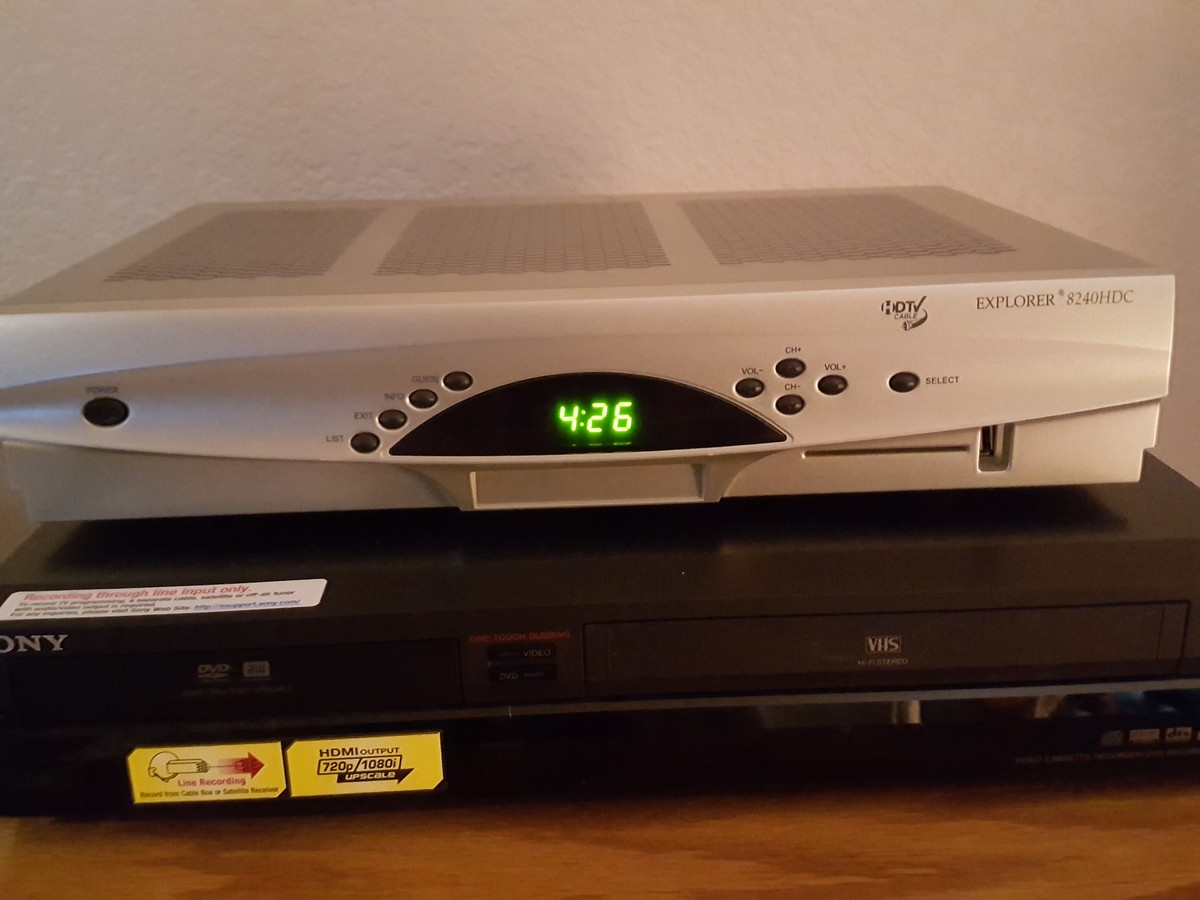

Thanks for the reply I was not home when I initiated this post I've taken some pictures.
The old cable box DVR I'm currently using in the man cave
Explorer 8240hdc

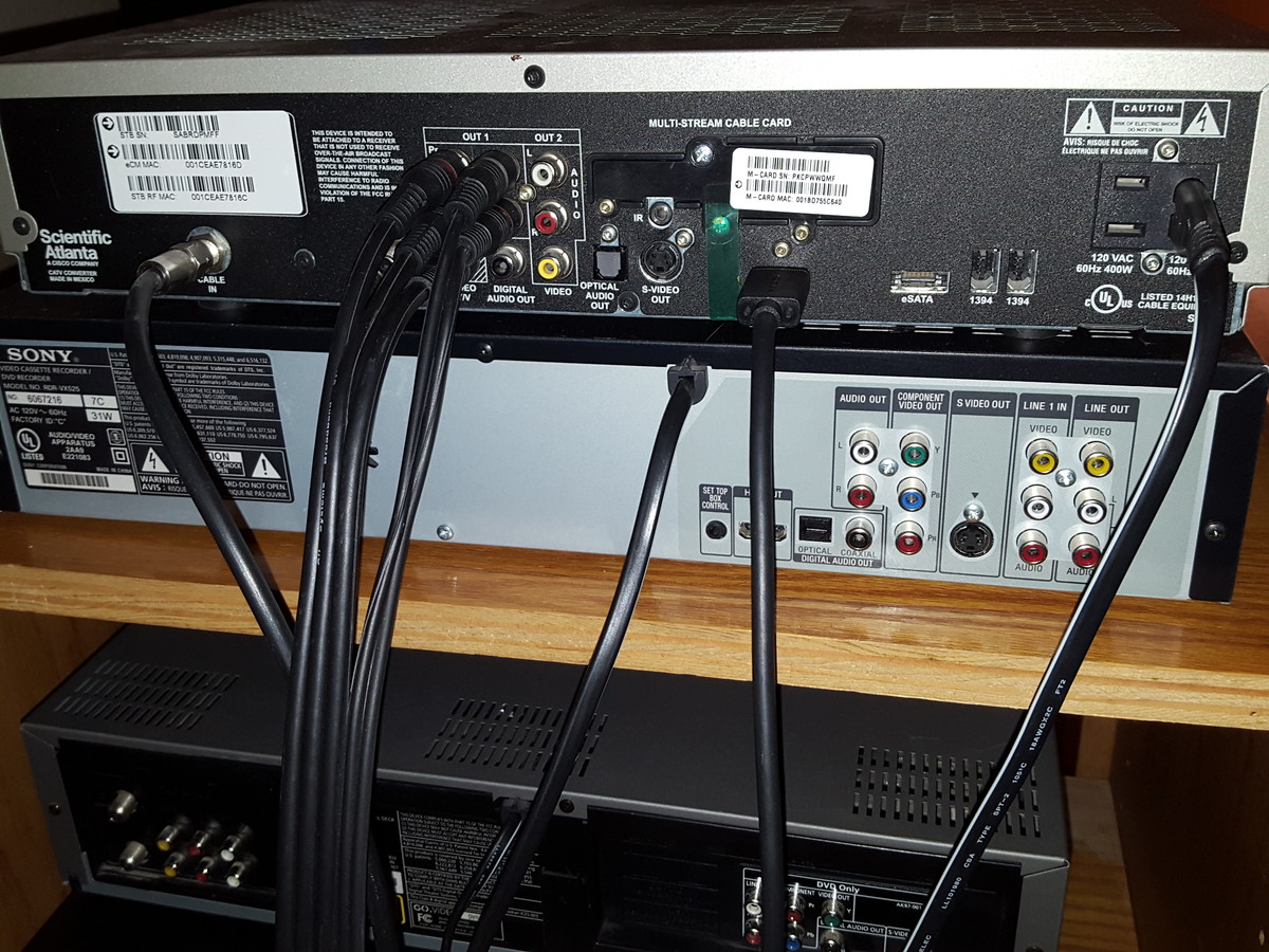

I'm still having to use the five cable harness from the DVR to the receiver. I thought with HDMI you no longer needed the five cable harness I tried the HDMI to the receiver input and then another HDMI cable from the receiver to the TV and I got no sound.

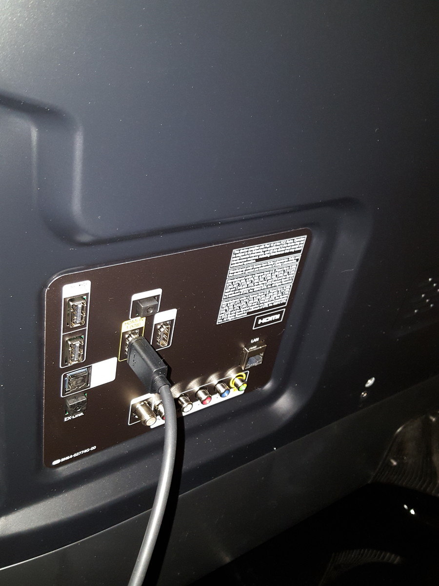

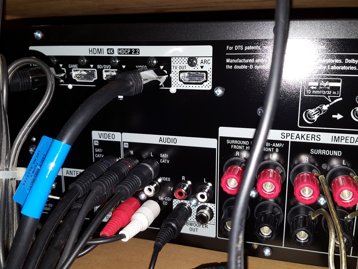

To get sound from the TV or any at all I had to run a HDMI cable from the cable box directly to the TV.
it seems odd this is the only connection to the TV.
Here is what I ended up having to use and it seems like I'm back to the same cabled mess as before not quite as bad but if it was correct I should just have some HDMI cables right?
I just went back down and disconnected HDMI cable with the BLUE TAG that was incorrectly installed on the receiver I removed it completely and now I'm getting surround sound again! :)

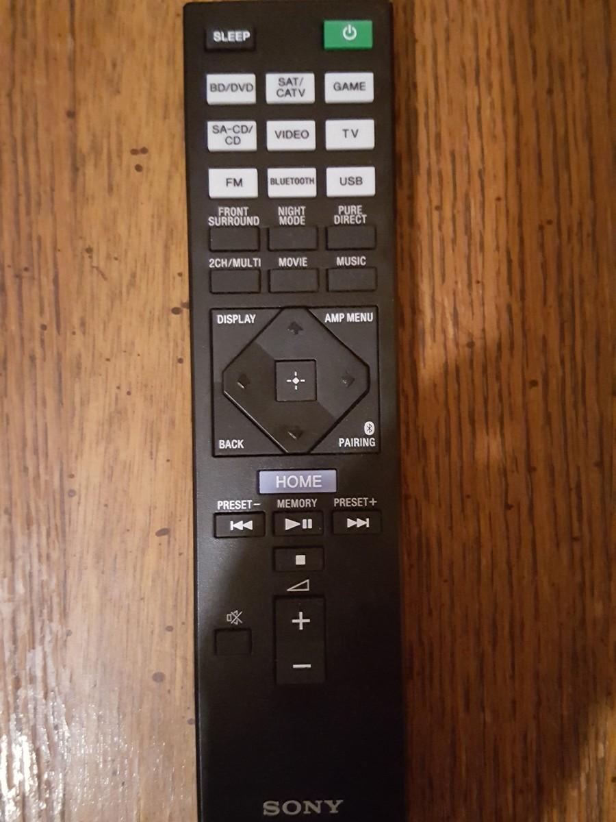

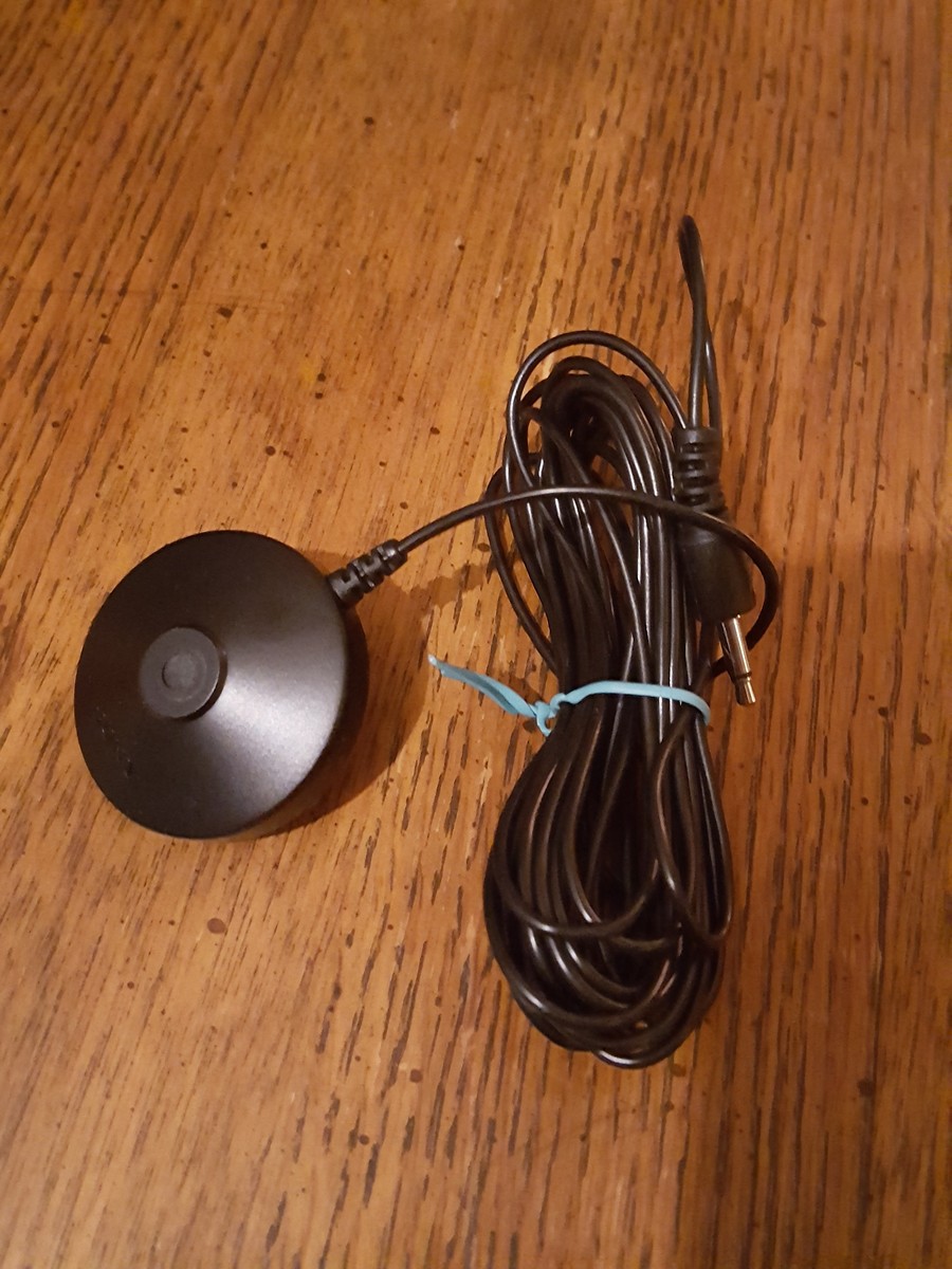

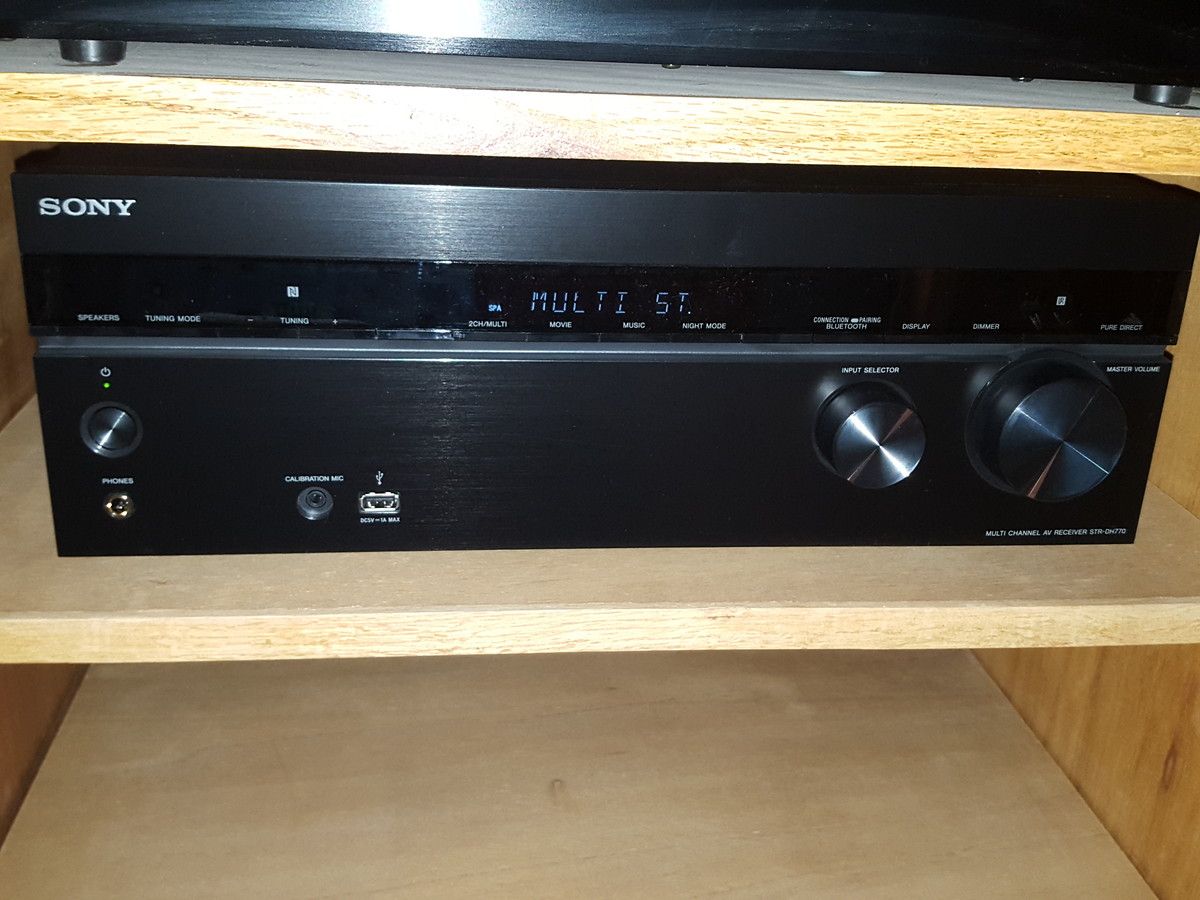

That's good to know here's some pictures of my remote and the receiver.
Playing with the remote I only get all 5 speakers working if I use the 2-channel multi button and click it a few times so that it displays multi stereo on the receiver so is this correct is this the Dolby Pro logic new version?
The basic paper manual kind of sucks it wants you to go online or something and I have not had time to do that yet also there is a little microphone that I guess you can adjust the speakers with I've never heard of anything like this what a pain in the ass.

Hi Gary,
Welcome to the Forum. I have a Sony Receiver STR-DN1050 on one of my systems which is a couple years old and was rated by this Forum as the best available (at the time) for $1,000 or less. So don't think that yours is not a decent rig. You need to take some time to digest the differences in technology since you got your Kenwood in 1993.
Here's the on line version of your manual: https://esupport.sony.com/CA/p/model-home.pl?mdl=STRDH770&template_id=1&region_id=3&tab=manuals#
Here's the printable version in case you want a hard copy:
https://www.google.ca/url?sa=t&rct=j&q=&esrc=s&source=web&cd=2&ved=0ahUKEwjDx4qvse7RAhXnqFQKHYRJCBsQFggfMAE&url=http://helpguide.sony.net/ha/strdh77/v1/en/print.pdf&usg=AFQjCNHYfQXsE_PzHBb5U19F5CY4d-13ew&bvm=bv.146073913,d.cGw&cad=rja
I suggest you open the on line version on a Laptop (or iPad) if you've got one and carry it over to where your system is set up.
I'm going to take a few minutes and try to help you with this setup. It's not anywhere near as hard as it seems. It's just you are not used to it. I will break it down into manageable steps.
If you would have used the Easy Setup wizard as described in the manual (it came on when you first turned the receiver on) you would have used that simple Mic and it would have helped you setup the speakers. The auto tuning Sony uses is ok but not as good as my Denon receivers use.
Seeing the rear panel connection points of your Cable Box is probably more helpful than the front
I can't post the photo but here's a link to it: https://www.cox.com/content/dam/cox/residential/support/tv/images/Cisco_8642HDC_back_diag.png
I can't make out the model of your Sony DVD/VHS machine but I'll bet it's like my Mom's and the VHS section won't output via the HDMI Cable but the DVD section will. Tell us the Model and I'll look for a manual and see if there is a work around.
Below is the rear of your STR-DN770.

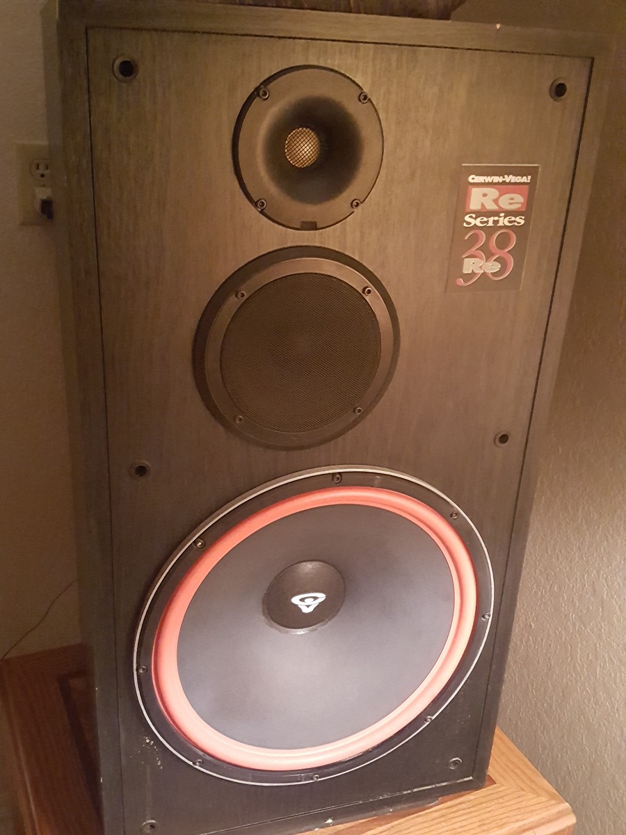

Your speakers are:
Cerwin-Vega RE-38's. I believe the specs are:
Power Handling (RMS): 5 to 400 Watts RMS
Frequency Response: 27Hz-20kHz
Sensitivity (dB): 102 dB dB
Impedance (Ohms): 4 Ohms
So use a bit of caution there as your receiver is supposed to be connected to 6-16 Ohm Speakers as per the label above the connections. It's not advisable to use speakers of a lower rating than specified as this will make your receiver work much harder and put undue stress on the receiver. Using speakers of a lower than specified rating may cause the 'Protection' mechanism to activate if you turn the volume up too much, this is by design to protect the receiver from damage. But you have what you have. The blessing is the Cerwin Vegas are very efficient and shouldn't take a lot of power to light them up to a decent level => so the 4 ohm point may be mute in your case.
See:
https://us.en.kb.sony.com/app/answers/detail/a_id/42605/c/65,66/kw/speaker ratings/session/L3RpbWUvMTQ0OTY3Njg5My9zaWQvTk9vb2h5RG0=
Most folks these days use their Receiver as the "hub" and connect all of their equipment through it via HDMI cables, and then from the receiver to the TV. Those with Cable Boxes typically don't use the TV for anything other than a big Monitor. You made a simple mistake and didn't connect from the STR-DN770 via the TV out / ARC (Audio Return Channel) HDMI connection. When facing the rear of the STR-DN770 it is the HDMI output on the right with the white pattern around it.
Connect your Cable box to the Sat/CATV HDMI input, and your Sony DVD/VHS combo to the BR/DVD HDMI input. Once you connect your TV to the receiver you should be good to begin setting up your system.
