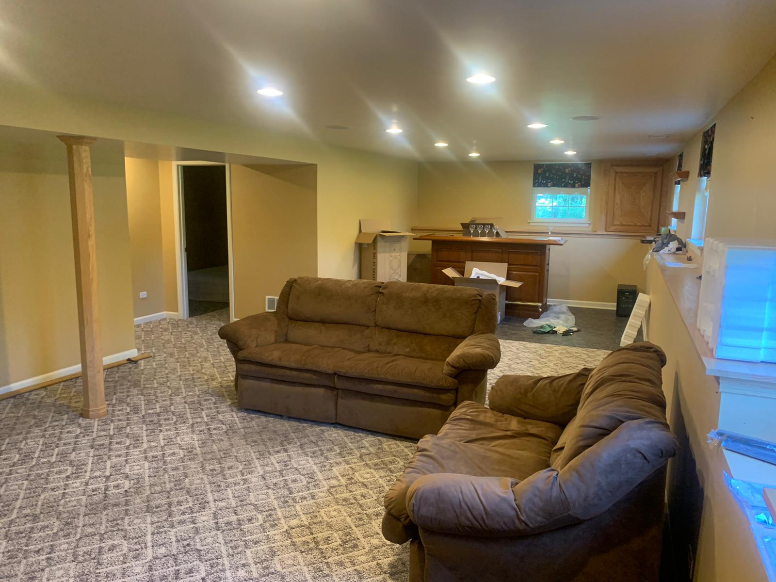

I will upload a picture here with the current layout of the room for reference.

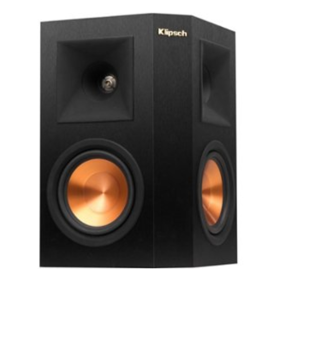

You could mount these on your side walls
Don't know what in-ceiling speakers are already there. But I would recommend if you use them to get Aimable In-ceiling speakers. Klipsch does make them.

Thanks Mazersteven. Should I use those R-41SA's in conjunction with the ceiling speakers? How should I assign each? R-41SA's as the Surrounds L and R and the ceiling speakers as SBR and SBL?

how would the R-41SA compare with the RP-250's? I know the 250's are a step up and twice the cost, would it be worth it? I have to say, I do not have a finely tuned ear. I am definitely a novice listener

The 250's are Floorstanders if Im correct. You could use Floorstanders or Bookshelf speakers as Surrounds. A little challenge in Cable Management.

You could mount the R-41SA's on the side walls and use the Rear In-ceiling speakers as Rear Surrounds w/ Aimable drivers to the Listening Position.

I have considered it, yes. Those couches are actually going to be on the curb here soon though. I also dont want to obstruct the TV from where the bar seating will be, for events such as the Super Bowl
