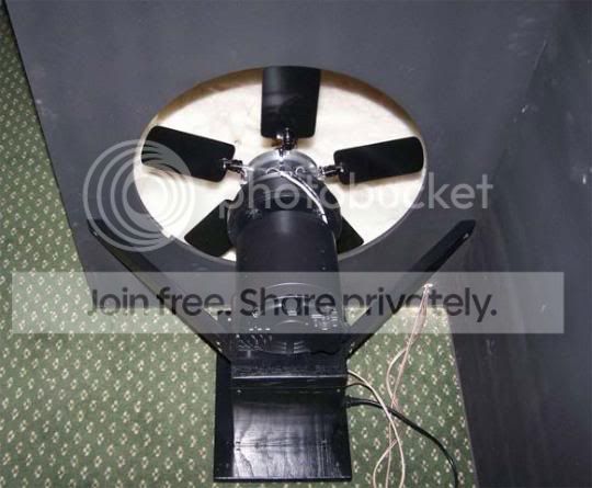

Well, it's a pulsating fan (oversized voice coil and magnet) with pitching blades and a massive motor. It's a neat design, adding extreme air pressure to a moving "blade" driver.

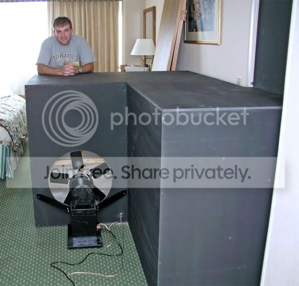

Here's how to get the rotary sub to work:
B
billnchristy
That enclosure is HUGE!
You could solve the homeless problem building a few of them and putting them in parks.

Buckeyefan 1
Buckeyefan 1
Phil,
LOL... That's not me. I got that off the net. Never would I (even if the wife allowed me) put that obstruction in my living room. Now a Plus/2 - absolutely. They make great end tables. ;)
B
billnchristy
You know, the more I look at that, the more it looks like a hotel room.
Scary...I wonder if they know he took the door off!

What horsepower rating is that motor?
How fast is that thing turning? Looks about twice the size of the 1HPs in my spa!
The explanation indicates a vari speed controller.
Must be for adjusting frequency range or would that be the volume?
Anyone have an idea as to what the general principle being used here is, to create, transfer and modulate LF sound waves?
Does it work by transfering the sound vibrations to the spinning rotors and then the small waves, started in the blades, are amplified in the box/through the air?
Is the fan pressurizing the box??

The fan turns at constant-speed. The pressure wave is created by changing the pitch of the blades, so they alternate between blowing air in and out of the box so that the air-pressure in front of the fan oscillates. See the explanation at http://www.rotarywoofer.com/ and http://www.eminent-tech.com/howitworks.htm
Changing the fan-speed would (presumably) change the volume, the faster the fan moves, the more air is moved by a given pitch of the blades.

The benefit to the listening experience was significant and something I think is worth persuing. Heck, the experience spurred me to go back to an idea I had sketched up before but not gotten around to building up yet. I personally think there are other ways to get a good likeness to this device in closed rooms without spending >$10k. We'll see soon enough.
Being "worth it" is a matter of perspective. If you had a crawl space, basement or attic adjacent to a theater, this would have no intrusion to your space and be simple enough to install or have Bruce's team install for you. The big boxes shown in the pictures above were used to convert a hotel doorway (of connecting rooms) to a baffle/manifold for a demo at an audio show. The manifold is needed with ~3 bends and a bunch of fiberglass to attenuate the self noise of the motor and the blades.
