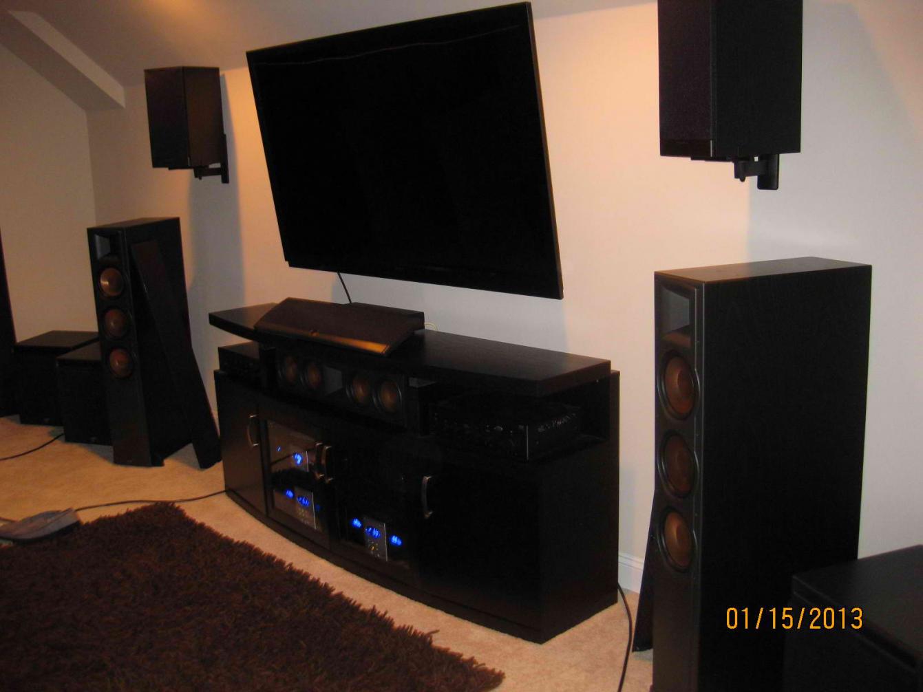

Yes I also share a soft spot with klipsch have had these for years and loved them. Just stepped into a different realm with separates now and started reading/researching deep into the new RF-7iis. To be honest I have always wanted RF-7s and when I got my 83 I loved them. I understand them being a lateral move but Im not sure they sound the same. I have read great things about the new RF-7iis that they are more detailed and in your face but still have the smoothness of the 83s. that is what im looking for. I could swap and start with different speakers as well such as lower DB 3 ways etc but id have to sell my height and 4 surrounds as well which I could do. Just wondering if id be better suited to set up new RF-7iis with a new RC-64ii and that Anthem A5? I don’t have room for 3 La scalls the mains sure but not my center lol. I’ll post a pic of my theater room to show you what I mean heh.

Yeah, I saw this room in your other thread.
The distance from your fronts to your listening position is far too short for speakers like RF-83 (or any big Klipsch for that matter). I would scale things back a bit if I were you, and look specifically for speakers that do well in your essentially near-field setup. The B&Ws you're considering would be better than the Klipsch, but you can probably do even better for such intimate listening distances. KEF? Check 'em out. They would work rather well in your small room.
Since you're coming from Klipsch, you will most likely be sacrificing dynamic prowess for better performance in other areas. Be ready.

Hmm always loved the way the sounded in this listening area. I sit about 13 feet from the front of the Old 83s your saying a much smaller speaker would be optimal? The room is 15’ wide and 23’deep 9’ ceilings. This was an older pic I have since put up acoustic panels on the sides and rear wall as well.

Your old Klipsch are a rather large array of drivers. It takes a minimum amount of distance for the output of the array to blend into a cohesive front. Your room's dimensions have you fighting against this. As far as Klipsch and your room go, I think the KL-650 THX would have been a more sensible choice for your mains originally. (If you decide to stick with Klipsch and are willing to go away from a tower, those are really rather good speakers worth considering.)
If you really want to do this right, get Floyd Toole's book on acoustics, study it, and get ears on an assortment of different speakers to put Toole's info into context. While speakers may be gorgeous furniture and nifty toys, they are fundamentally tools for music reproduction and should be chosen accordingly, as determined by the room and the user's particular demands.
