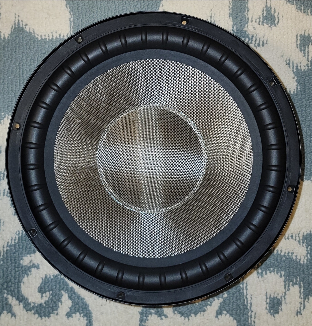

Hello,
I'd appreciate some help on this...
Long story short I ended up with a new 4ohm Episode Evolution 300 (12 inch) Sealed Subwoofer, still in box, in pristine condition... one of those that dealers install, not normally available for purchase by general public.
Anyhow, I connect. It powers on & Auto sensing led comes on but no sound.
Next I check impedance a few times & I get either a 3.9 or 4.0 on the multimeter. However, when I'm taking the readings, if I (even gently) tap, touch or push on the cone or dust cover, the readings for impedance (and continuity) on multimeter drop to all zeroes instantly.
This means there is a short, correct?
Some videos I watched & other forum posts said this is indicative of a short. Any thoughts on how I can attempt a fix? Also I've unscrewed everything I can on it & it doesn't seem like I can get to the coil without damaging the cone, dust cover, etc. Any ideas??
Thank you & truly appreciate any help or thoughts on this...

I suspect the driver is fine. When you press on the cone a voltage will be generated at the terminals which will upset the meter.
Connect a 1.5 volt battery to the speaker terminals, if the cone moves in and out as you disconnect and connect the battery, the driver is fine.
If the amp is detecting the input, but you get no sound, then I suspect the plate amp is bad. Subwoofer plate amps are notorious for failure.
What are you connecting this sub to? In other words, what is driving it?
If you start unscrewing things on the driver you will ruin it. Driver failures are rare, plate amp failures common.
A driver if it did have trouble with the VC, then the repair is complete cone replacement with VC surround and dust cap. Speaker glue and factory shims to center the voice coil are mandatory. If you keep abusing the driver, then that will be required. Do the battery test, and if it passes, reinstall it and turn your attention to the amp.
If the amp is no good, that is bad news as generally those plate amps are not serviceable.

Thank you so much TLS Guy, I believe you may have saved me from unnecessarily damaging the driver. Some posts on other forums & particularly because of This video at the 2:05 mark made me think pushing down on the cone indicating a possible a short.
However, I just tried the same thing with a small speaker I have & reading on it also go to zero so you were spot on about the generated voltage upsetting the readings.

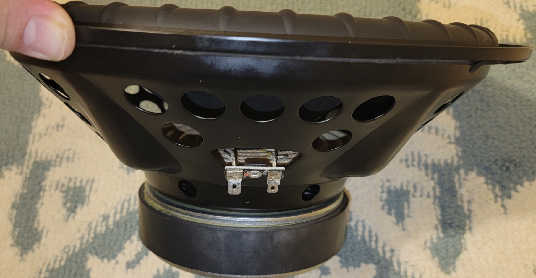

And sorry I had forgotten to mention previously... I had already done the battery test and the cone moves up & down perfectly. To answer your question, I have a 5.1.2 HT but my receiver can take another sub, so I was hoping to get to a 5.2.2.
My other sub that is working is a Def Tech 10" powerfield Sub (not a sealed sub like this one). Can I use the amp on that to check definitively if its the driver or amp on the bad one? I am new to all this, so if it does turn out to be the Amp for sure & you said its not serviceable, do I just chuck all of it in the trash...?? I checked & this was roughly a $750 Subwoofer new (used ones on ebay are roughly $350), so pricier than my Def Tech sub. The watts on my Def Tech Sub are listed as 700, and I believe this one is same thing, could I install the def tech amp on this Sub or are there other specs to consider?
Thank you again, truly appreciate all the detailed info you provided. If nothing else, I learned a ton from your post.

I can tell you for 100% certain that your driver is OK. Do not mess around and risk damaging gear. If one sub works off that cable and output, and this new one does not, I can tell you for certain the amp is bad and needs to be replaced.
We do try here to give correct information, and forcefully confront and correct BS. We do have a selection of very experienced members here.
