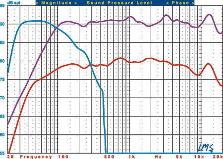

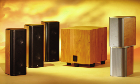

Shanman
Shanman
Apparently the Basis 300 I have is the follow up model to the above ICS Sub300.
avrev.com says "Snell is also releasing a forward-firing subwoofer called the Basis 300, which is said to offer nearly identical performance, but with a cabinet styled like the LCR7 and K7. The 10-inch woofer is flanked by dual ports that help the unit achieve an extended low end down to 25Hz, with a maximum output of 110dB."
Using just the towers in my current stereo set-up, am I missing out by not running a 3.0 arrangement or is this a no-no for a dedicated music system? That matching center speaker is just sitting collecting dust. I can't bring myself to set the towers and the center up in the living room for A/V. My two young ones would end up jamming a finger through the rear firing tweeter or something...
