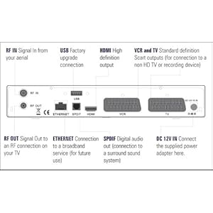

ok
Any answer but probabbly hope:D i was right
when i look some HD Boxes i was find that some have SPDIF Digital audio out
if i got this right when i gonna buy then 5,1 hometheatre with SPDIF input
then i am cover with 5,1 sound
