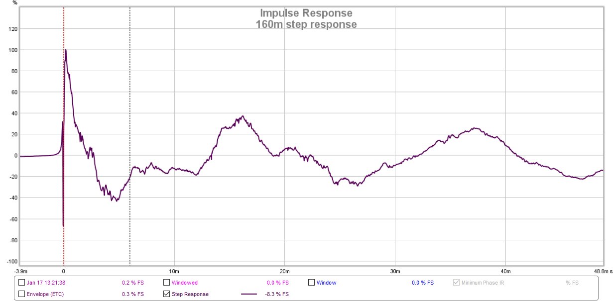

I'm addition, unlike previous versions of the reference series, where the tweeter was a few microseconds ahead of the woofer, the step response of the RP series shows that the woofer and tweeter are almost perfectly time aligned. Whether time alignment is beneficial or not, is a matter of debate (@Tlsguy seems to be of the opinion that it is).
The absurd thing about time-aligning these drivers to such a fine degree is that it is well beyond human audibility. Furthermore, that only happens at a single plane in space on the horizontal axis. EVERYWHERE else is not time aligned. All acoustic reflections that occur in a vertical space will not be time-aligned so perfectly, and that is like 99.9% percent of them. If you want a real time-aligned sound, you need either an amazing coaxial speaker, or a full-range driver. Full-range drivers can have all sorts of problems.
I'm not sure if time alignment is that important either, but I do know it's easy to hear large differences in bass time alignment even if the FR appears flat. For example, one of the major corrections audyssey does is correction of both the response but also the phase. Sitting along the rear half of the room causes certain ranges of the bass to be almost 180 degrees out, and I can easily hear a difference between the corrected phase response and the uncorrected response, even though the response was flat to begin with. Out of time bass sounds slow and sloppy.
I don't think that the minor high q variations in time introduced from the room reflections really matter, but the question remains, if the tweeters output arrives earlier than the woofers, is that noticeable? I am not really sure, it'd be interesting to test out. I do know however that based on the step response of the RP series they're aligned, whether this is audible or not.
Everything past 6ms is room reflections.
Sent from my LGMP260 using Tapatalk
This measurement shows a speaker that isn't time aligned either; it's just way too large of a scale to see the details of the driver responses. Zoom in and just show the first 5 or 10 milliseconds and you will see individual peaks for the tweeter response followed by the woofer response.
