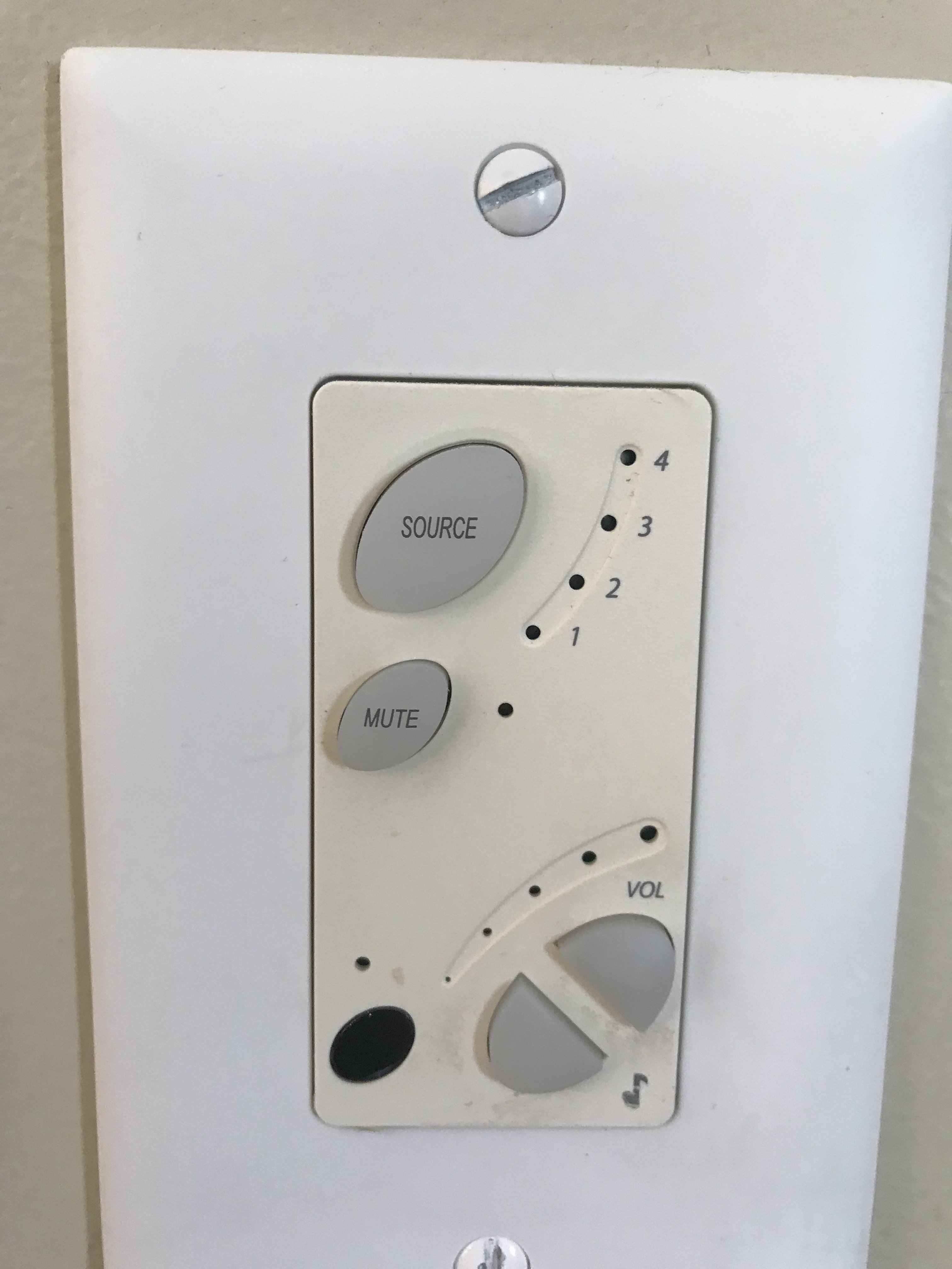

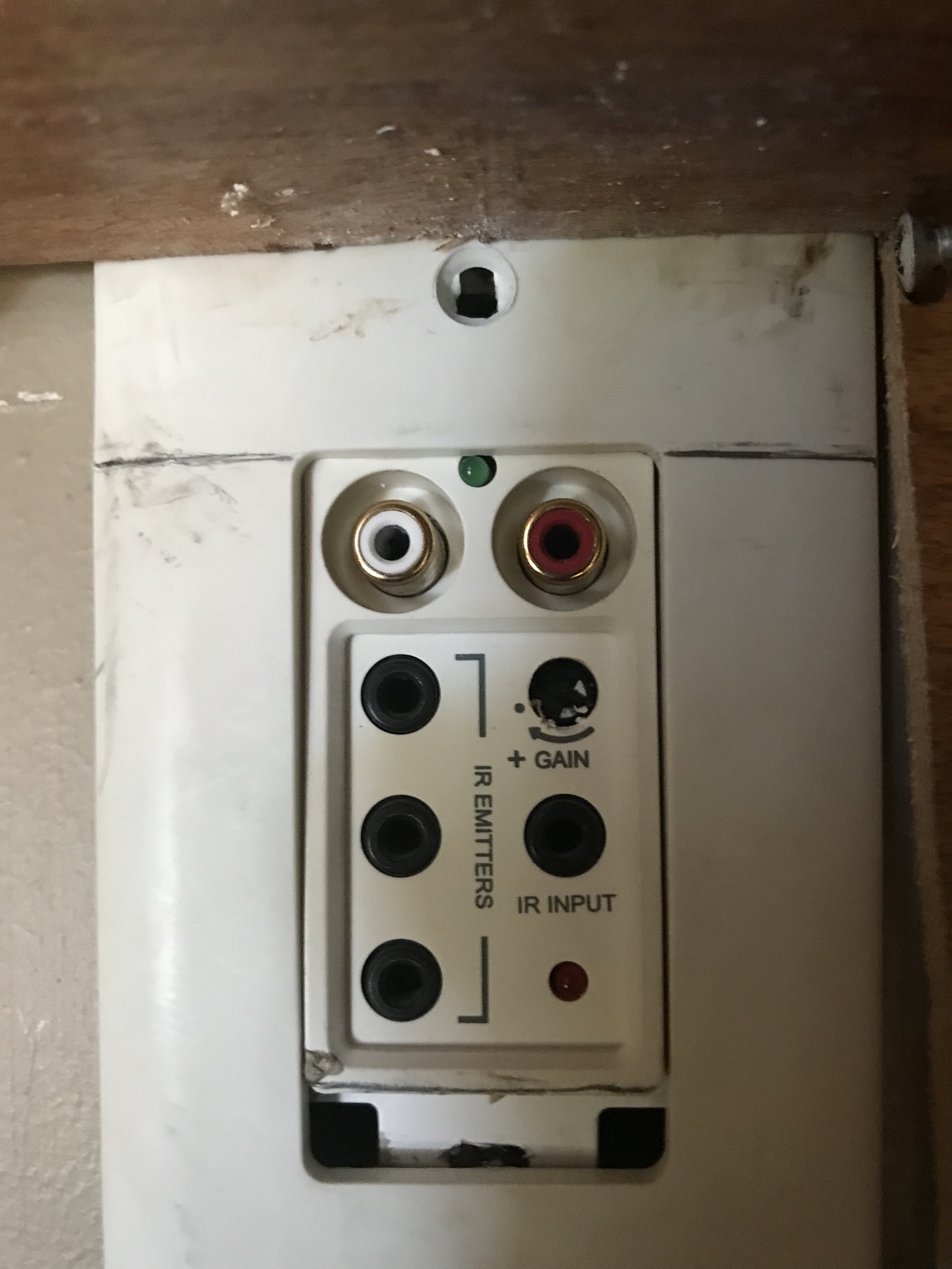

So we just moved into a new home that has built in speakers in the living room, kitchen, master bedroom and deck. Each has their own control on the wall and there is only one place to plug into the system in the living room. I do not have a receiver but tried to test this by hooking up a tv to this but get any sound and didn’t seem to have any power. Can anyone help? I’m attaching pictures of the wall controls and the input.
I'd try and find what that panel on the left is connected to. Since it just appears to have a line level input I wonder if that connects to an amp (that they may have taken). Always fun when trying to figure out what's left in a whole-home system you have no info on....

Pull the volume control/source selector out of the wall. It looks like it may be a Russound piece of gear, but I can't tell. If the old homeowners took the main amplifier/source selector with them, then you may want/need to reach out to them as they should have had it convey with the home. Just like the speakers and wall controllers, the main unit is the heart of the system and renders everything else nearly useless without it. They are often out of production and impossible to get replacements for as well. Making it even dumber, you often can't get new volume controls/controllers for existing main units, so the main unit they may have taken with them is completely useless to them! This is very circular, but the first step is pulling out the pieces from the wall and seeing the exact manufacturer and the model number of those pieces so you can find out what else is needed. It looks very proprietary.

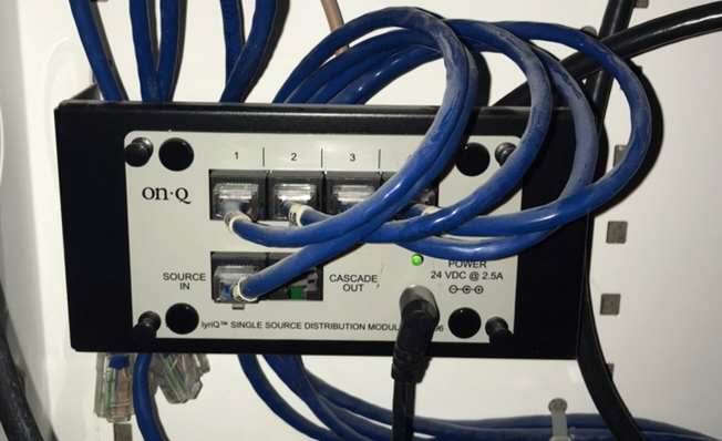

I did figure out that this appears to be On-Q stuff. Looks like it is a part of this series...
https://www.crutchfield.com/S-TffcgsUp3ek/p_717AU1003W/On-Q-lyriQ-4-source-4-room-Audio-Kit-White.html
Looking at the manual...
https://pdf.crutchfieldonline.com/ImageBank/v20080824111800/Manuals/717/717AU1003W.PDF
If there is a wall-box in the basement, then the On-Q distribution hub could be located in that location. The keypads are 7.5w amplified units which connect directly to the speakers in each room. So, cat-5e from the hub to the keypad, then 16/4 out to the speakers.
The only thing that is really needed is plugging in a source and selecting it from the keypad. There may be a 3-input source hub in the box as well.
We need a lot more information, and if you have a white On-Q box (or similar) in your basement/garage/somewhere then you should open that up and look inside for associated equipment.

I wish the OP was back to let us know what they found out, because by the look of things, this entire system should not have any pieces which exist much outside of a central distribution box in the home, and they may be able to reach out to see if there is a ON-Q piece which the seller took with them that is otherwise useless to them. This system does appear to be pretty much stand alone. There are certainly some parts and pieces which ON-Q still sells.

Apologize for being gone, but we finally figured it out today. Thanks to your responses, we were able to locate the on-q box in the basement. We did an initial test and it worked. Now we can proceed with getting everything connected and can put this system to work.
Thank you again for your help. My family and I appreciate it.
