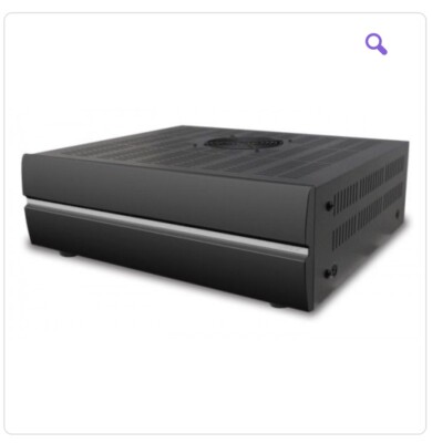

More advanced would be to use an amplifier which can drive all the zones with their own discrete power. This would come from a 16-channel audio amplifier.
These can be had from about $400 or so on eBay. But, you want to be sure they ship with the Phoenix connectors so you don't have to go looking for them after the fact. The bare wires terminate into Phoenix connectors directly and they are a commonly used item in whole house audio (WHA) setups.
