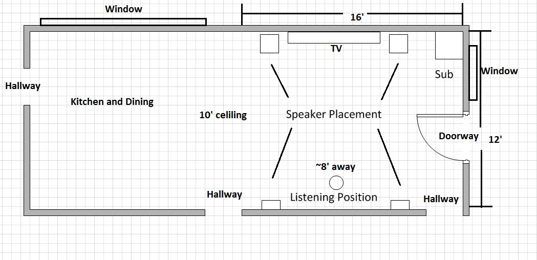

I’ve been browsing these forums for quite some time now, but I recently decided to create and account and dive into the journey to a home theater for my new home. I’ve attached a layout of the area I have to work with for your reference. It may not be exactly to scale, but it should give you a little idea.
I’ve been looking at speakers for quite some time now, and I am finally ready to pull the trigger. I’d like to go with a 5.1 system. However, the nature of the room I have to work with has left me with questions. So here we go. Below are some quick facts before I get into the questions.

  1. I feel as though my room may be on the small side when comparing to others. How much do you guys feel room size comes into play when looking at floor standing speakers vs bookshelf?
  2. Is there any rule of thumb for sealed vs ported subs? Downfire vs front? I would like to start with one sub placed in the corner area of the layout.
  3. Any recommendations on arrangements based on the layout?

Your room isn't that small, but I would go for bookshelf speakers. You won't need tower speakers, they won't do you any more good than bookshelf speakers if you are using a sub. The Sierra 2s look really good, I don't think you can go wrong with them. I would also be looking at Wharfedale Jades, outstanding speakers.
I would go with a ported sub in that size space, I would be looking at the ported 15" subs from Hsu, Rythmik, or Reaction Audio. The orientation of the driver doesn't make a difference here, down-firing, front-firing, it's all good.
With a 5 channel system, Atmos won't do you any good, I wouldn't worry about Atmos.
With your listening position against the wall, you might rethink having surround speakers altogether. It is awkward to set them up in such an arrangement in a manner where the speakers don't draw attention to themselves.

Listening position is about 2 foot or so from the wall. Would bipole help with surrounds or should I not really consider them at all? Thanks!!

wattage doesn't make a difference, end performance is what counts. I wouldn't pay much attention to wattage. Bipole surround might work in your situation, but I would only give them a try without getting married to the idea. If it proves to be a distraction rather than immersive, return the bipoles.
