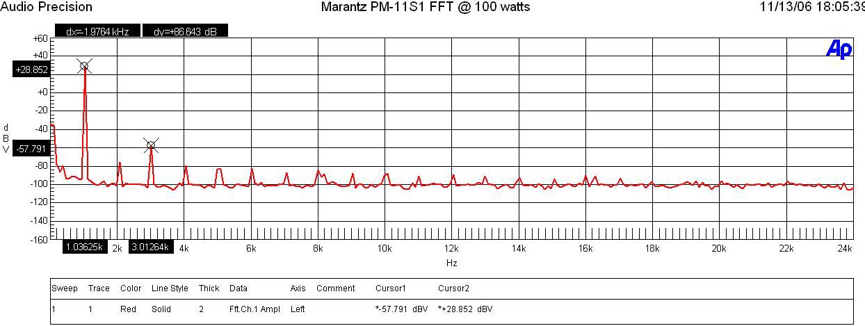

FFT Distortion Spectrum - you want mostly 2nd order harmonic distortion if any (2 x the tone) - if it's 1.5 khz tone you might see a bit of 3khz but hopefully 4.5khz, 6khz, 7.5khz distortion is close to the noise floor:
http://www.audioholics.com/reviews/amplifiers/marantz-pm-11s1-integrated-amplifier/FFT-100watt.JPG/image_view_fullscreen

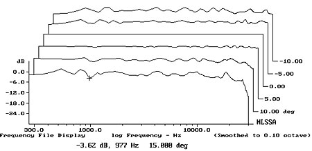

1) Smooth off axis plots. These are an indicator of listening position and room sensitivity. I'd say similar performance out to 60 degrees, or maybe even 90 degrees, is fundamentally important
Here is a pretty good one; although it does get a bit ragged above 10khz you have to remember that this is barely an auible octave whereas everything below it is the heart of music:

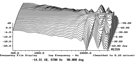

Here is a bad one; the type of speaker where if you move your head even a bit you'll hear a change in sound. These types of speakers are AKA audiophile speakers and you would not believe the price of this one :rolleyes:

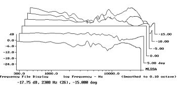

So once you've got a smooth horizontal off axis plot, ideally you'd think the vertical plot would be exceptional but I wouldn't say that's true. Here's two speakers with outstanding horizontal off axis plots and you can see the vertical is pretty different:
vs
Which of the above speakers is better? It's not as easy as it seems - as you can see, vertical polar plots of even well designed speakers don't may not look as good, and that means that the majority of speakers will benefit from attenuation of vertical reflections, one way or another. Some companies will use MTM speakers, which intentionally have limited vertical dispersion in the midrange to improve clarity, others will use coaxial drivers, and others just expect you, the owner, to deal with it in your room with all sorts of tricky panels. :D - the vertical plane is difficult to judge from measurements alone... auditioning can help.
