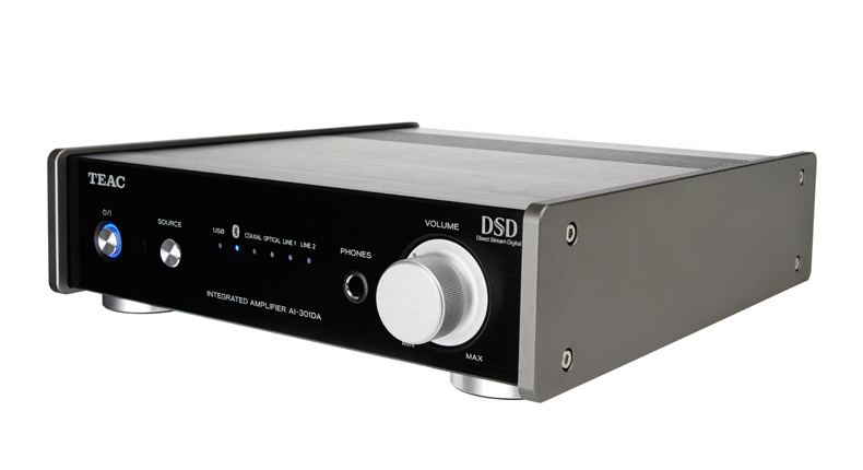

I think you are spot on. Yes, I am using this 2.1 for music with TIDAL as the source through my iMac by USB into my TEAC amp. I guess at this point I could only sink another $700 into a pair of bookshelf speakers. I don't have a lot of cash to play around with, and it sounds like you do, but if you were in my position (thankfully you aren't) what speakers would you allow into your home?

AND... your bass management situation might be sketchy with that amp. I don't know for sure without more digging, but stereo receivers aren't known for their great bass management. From what I see you didn't spend big bucks on it tho? Something with HDMI and a little more power would be nice, but let's get your speakers and subs sorted first.

I didnt see anything about a crossover in the teac integrated amps manual, so it might just send a full range signal out. Have you set up the sub with the controls on the back of the sub?
If the sub isnt set up properly it will likly sound bad no matter what speakers are connected.

This is exactly what I'm getting at when I say bass management. You have to strike a balance between speakers and subwoofer by filtering higher frequencies going to the sub, while filtering the lower frequencies going to the speakers. If you don't have bass management built into your receiver you need to figure out your speaker's f3 and adjust the low pass/crossover dial on the back of the sub to overlap.

I never even heard of a teac amp what model number, ? Any pics of your set up.

Your speakers are powered why you even need a teac amp ? Klipsch R-51PM Powered Bluetooth Speaker https://www.amazon.com/dp/B07FKCP7PZ/ref=cm_sw_r_cp_api_glc_fabc_2JW8CEK6S2EGY51RQ3H2

Cheap Towers ...not sure teac can power them tho .
