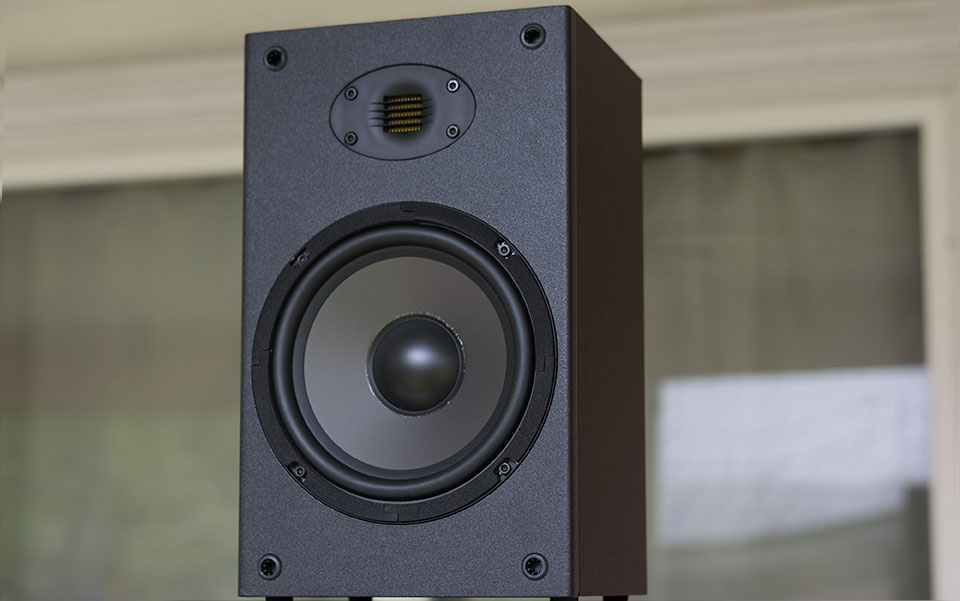

Don't laugh - I'd buy 3 pair @ $56 a pair. These Dayton Air's with the AMT tweets are very nice stock but with Fleawatt's simple mods the bar is raised considerably.
Which mods are those?
Dennis Murphy
I kind of suspected that's what was involved. Although it's hard to criticize a speaker that costs less than the shipping on most regulation bookshelves, there's no way to significantly improve the sound by upgrading the two components in the stock crossover or adding some fill. The problem with the speaker is that it doesn't have a low pass filter to deal with the woofer breakup modes. I tried to fix the problem, but the little AMT tweeter drops like a rock below 5 kHz, and that will leave a significant hole in the response once the woofer is rolled off. Here's the stock speaker's on-axis response:

Poultrygeist
I thought the Airs a definite improvement over the B22's I sold. Different strokes.
Dennis Murphy
Well, there was no implied endorsement of the BS22 in my post, although it does have tons more bass than the Air.
Poultrygeist
The sealed cabinet and larger woofer with it's more defined bass is just one of the reasons I prefer the Airs.
I also noticed a significant improvement by simply upgrading the single cap on the original B652's.
As I said different strokes.
