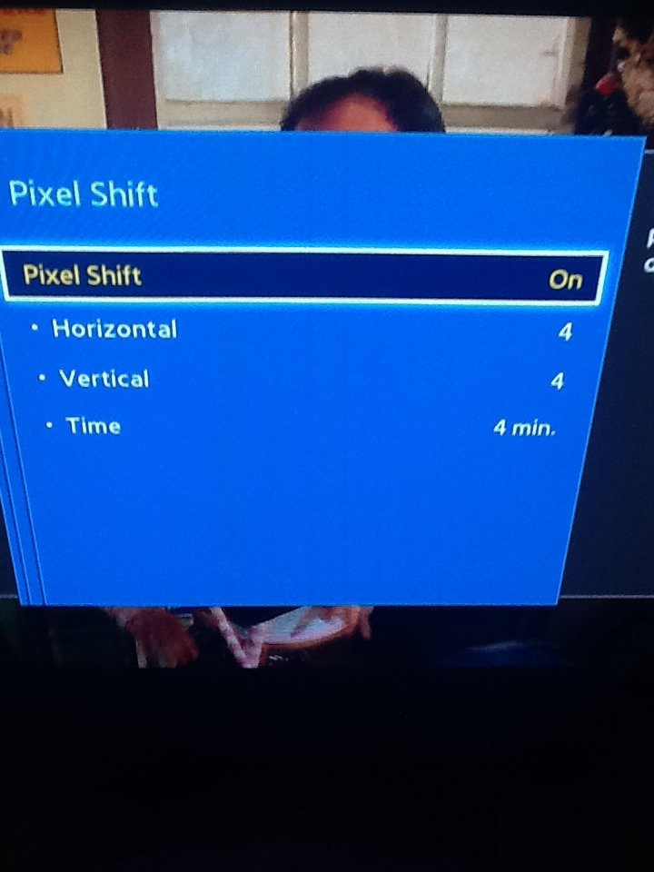

Go to menu > system > screen burn protection
Horizontal and vertical should be set to 4. Set it to do this every 4 minutes.

Burn in protection
You can only set it to 5 min which is the lowest. It's set like that from the factory

Are you in screen fit mode? If you're in screen fit mode it may keep you from being able to adjust all the settings.
Deathlok2001
Standard mode 1080.. You can change the burn in setting to 10 or 15. 5 is the lowest

I don't know what yo tell you, it's a scroll menu you cannot put in a random number
Any way you can take a picture and post it? If not, you'll have to describe what settings you see, what your options are, what is selectable and what is not, what your choices are for what is selectable, etc.
Otherwise, it is I that does not know what to tell you.
Also, if you read page 81 of the manual that supposedly goes with your TV, it should be 3 scroll menus. A vertical shift with choices of 1-4, a horizontal shift of 1-4, and a number of minutes 1-4. None of which you're putting in a random number. Since your menu setup does not match the manual, either Samsung posted the wrong manual, you have your model wrong, or there was a firmware update that changed the menu setup.

You can't shift right to change of the those options over the right that describes what I was talking about? on the right side of your picture it says something about configuring the horizontal and vertical shift as well as the time.
