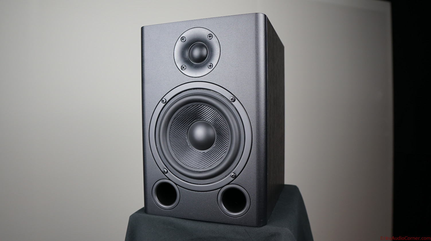

First off, here's the link to the review via my site. There is additional information there that I am not including here. I am just covering the highlights here. If you want more details look at the review page here: https://www.erinsaudiocorner.com/loudspeakers/neumi_bs5/
Intro
I stumbled on talk of the Neumi BS5 speaker recently in the context of a potential high-value speaker. Out of curiosity, I went to the product page on Amazon to check them out and liked what I saw. I then pulled up the Neumi’s BS5 manual here is the link where I saw placement recommendations, and some other bits of information which all gave me the impression the manufacturer cares about how the user listens to their product rather than the old “sink or swim” attitude low-cost products leave you with. Generally, when this information is laid out for the user it also implies the product is worthwhile. At least, that’s the impression I am left with in those cases.
At any rate, Amazon had them listed for $90/pair (at the time of purchase) and I figured they were worth buying to review and pass the information on to the audio community so you all could either avoid them or feel comfortable spending your hard earned money on. So, I did.
Ultimately, while these aren’t the best performing speakers I’ve tested or heard, I do believe these provide a good value to the budget-limited audiophile. And, with a few engineering alterations, could be made into an even better value. Read on for more detail.

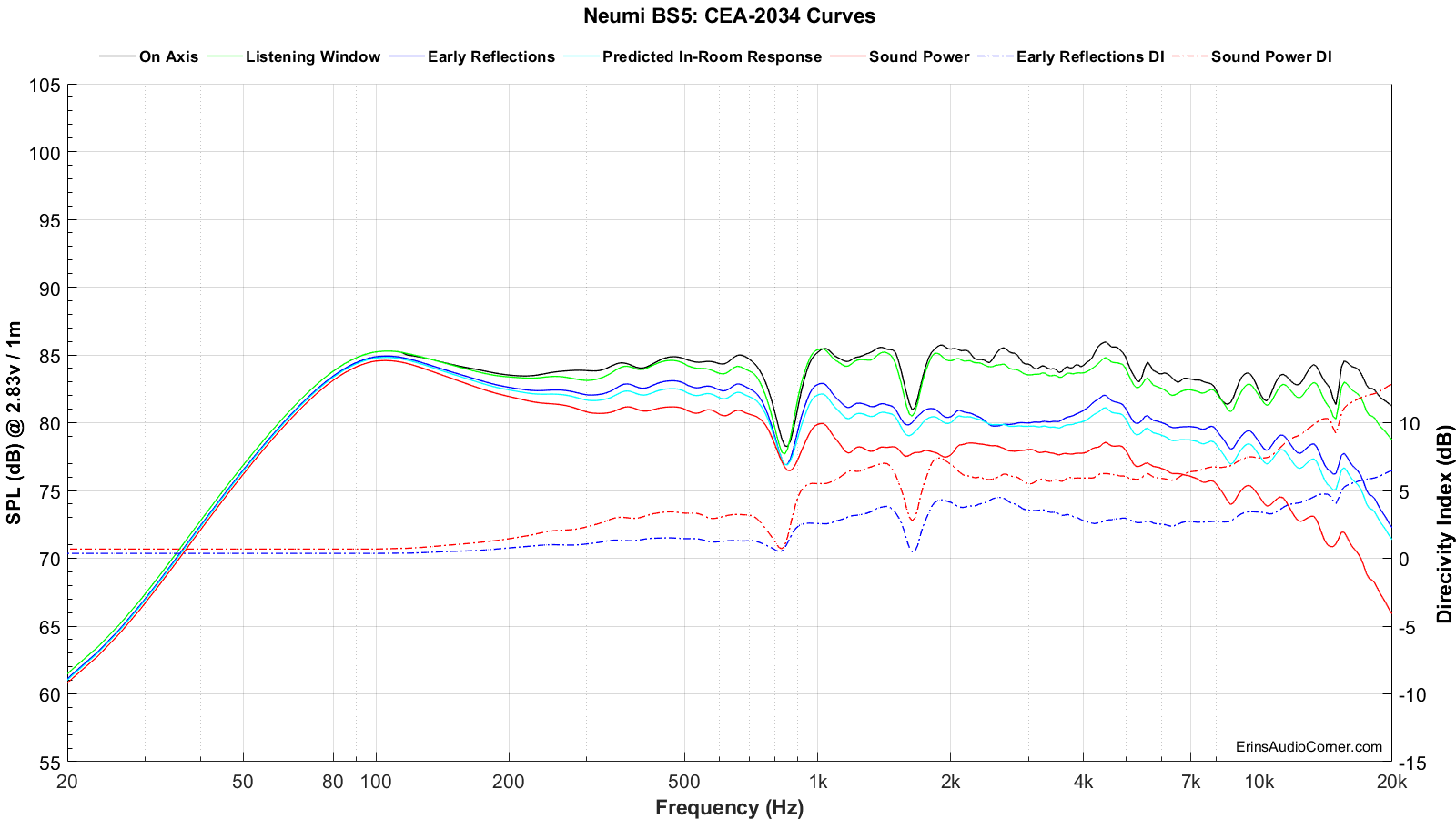

CEA-2034 (aka: Spinorama):
What we can learn from this data is that this speaker has significant directivity problems thanks to the deep nulls at ~800Hz and ~1600Hz. You can see it in the above spectrogram and globe plots as well as in all the measurements in the above graphic. The crossover is stated as 2.1kHz by Neumi and the nearfield data backs this up. Therefore, in this region you can see the directivity mismatch. Looking at 1kHz you see a rising DI until approximately 2.5kHz where the Early Reflections DI dips back down again. This is a sign the transition from mid to tweeter is occurring as the woofer is beginning to beam (radiate more forward than omnidirectional) and the tweeter is taking over, omnidirectional until approximately 6.5kHz (calculated based on dome size of 1 inch). The DI flattens out a bit through here but as the tweeter begins to radiate more directionally the DI increases again above ~7kHz. The tweeter rolls off sharply above 16kHz, causing directivity to increase further. What does this all mean to you? Well, mismatches in what is coming directly at you, on-axis, vs what is reflected around you can cause issues in stage and tonality cues.
Below is a breakout of the typical room’s Early Reflections contributors (floor bounce, ceiling, rear wall, front wall and side wall reflections). From this you can determine how much absorption you need and where to place it to help remedy strong dips from the reflection(s). Notice the strong dips again at 800Hz and 1600Hz.

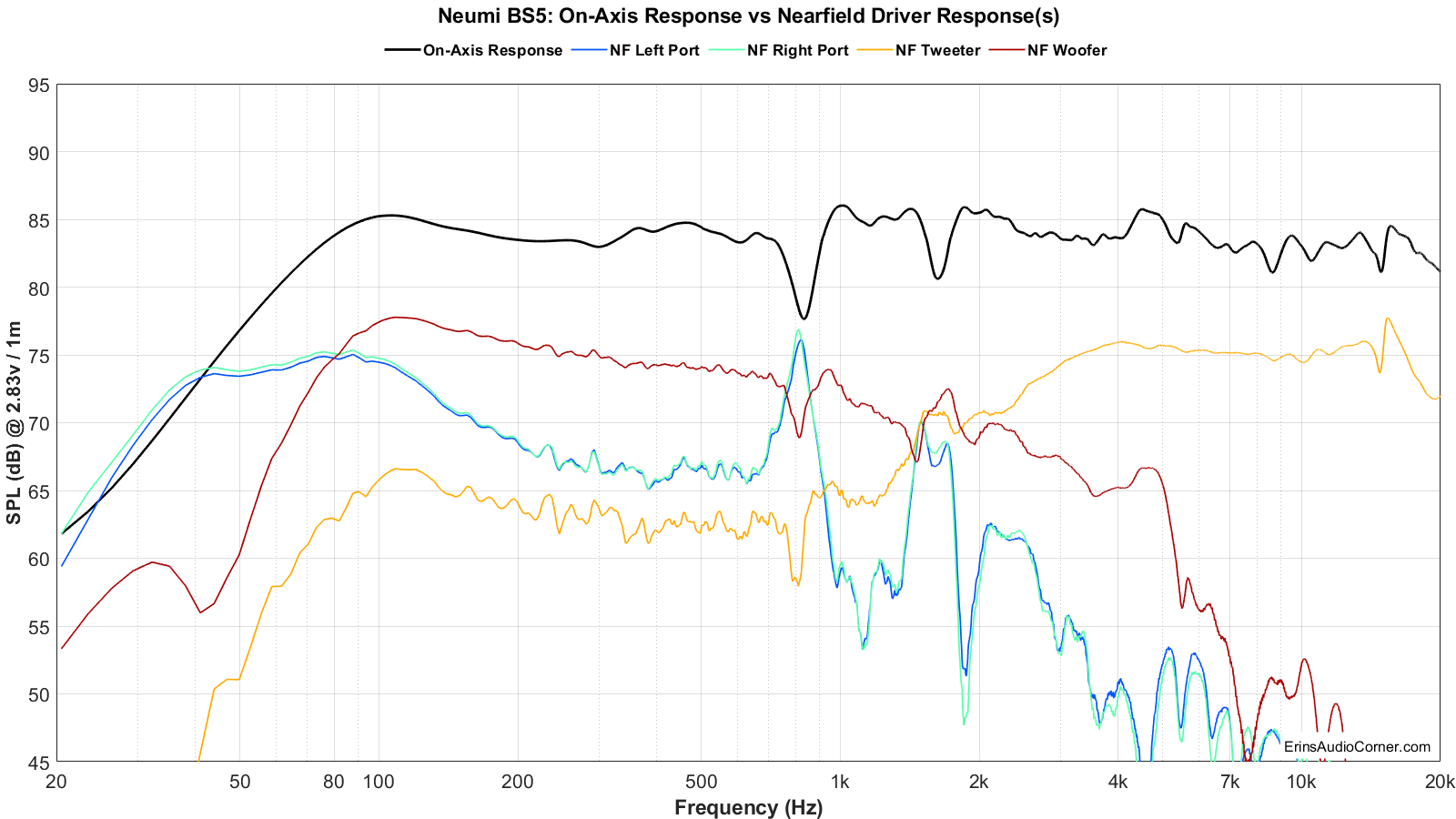

Nearfield measurements.

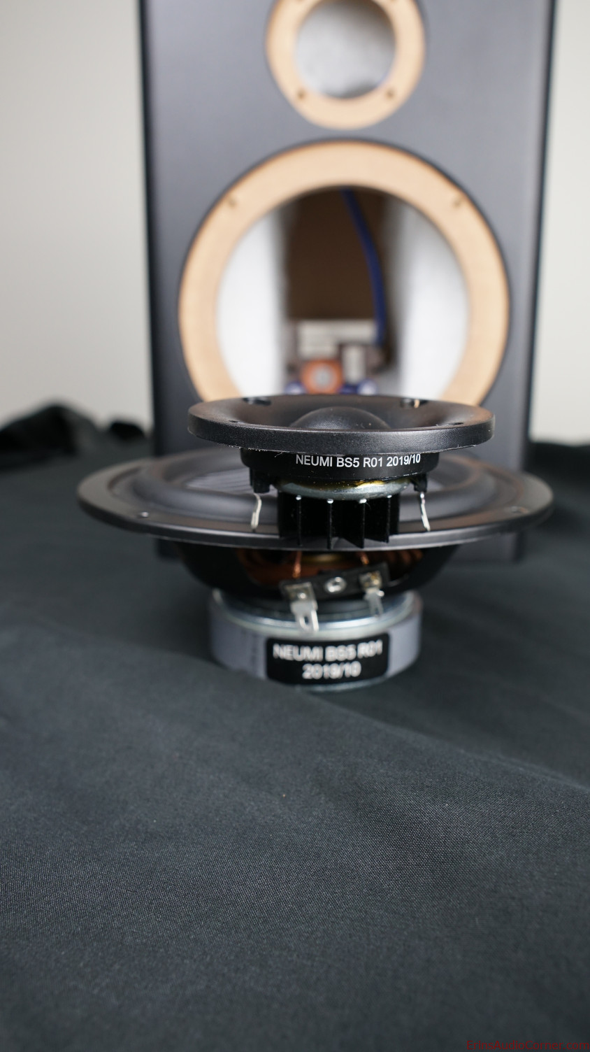

Mic placed about 0.50 inches from each drive unit and port. While I tried to make these as accurate in SPL as I could, I cannot guarantee the relative levels are absolutely correct so I caution you to use this data as a guide but not representative of actual levels (measuring in the nearfield makes this hard as a couple millimeters’ difference between measurements can alter the SPL level). Got it? Good.
There are a few noteworthy things here:
  • Port resonance is very, very strong and clearly contributes to the on-axis response dips at ~800Hz and ~1600Hz.
  • The area between 300Hz to 700Hz (just before the 800Hz dip) is elevated slightly. This area also lines up with the increased THD levels I discussed earlier. This could be coincidence. But I believe they are related. Maybe the port is having more of an effect in this region than it needs to?
  • Woofer break-up contributes to a few on-axis resonances we see. Particularly, 4.5kHz.
  • There are other things going on here but I don’t have the time to reverse engineer this speaker. Not that I could.

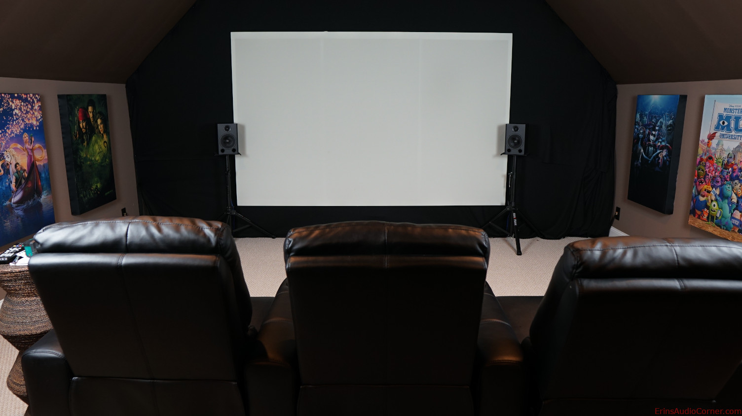

Subjective Analysis Setup:
  • The speaker was aimed on-axis with the tweeter at ear level.
  • I used Room EQ Wizard (REW) and my calibrated MiniDSP UMIK-1 to get the volume on my AVR relative to what the actual measured SPL was in the MLP (~11 feet from the speakers). I varied it between 85-90dB, occasionally going up to the mid 90’s to see what the output capability was. In a poll I found most listen to music in this range. Realistically, 90dB is loud for long-term listening volume and I find most overestimate their listening volume until an SPL microphone is used to determine the actual level.
  • All speakers are provided a relatively high level of Pseudo Pink-Noise for a day or two - with breaks in between - in order to calm any “break-in” concerns.
  • I demoed these speakers without a crossover and without EQ.
I listened to these speakers and made my subjective notes before I started measuring objectively. I did not want my knowledge of the measurements to influence my subjective opinion. This is important because I want to try to correlate the objective data with what I hear in my listening space in order to determine the validity of the measurement process. I try to do a few listening sessions over a couple days so I can give my ears a break and come back “fresh”. I also want to be as transparent to you as I can be so below are my subjective evaluations made before I began any measurements.
