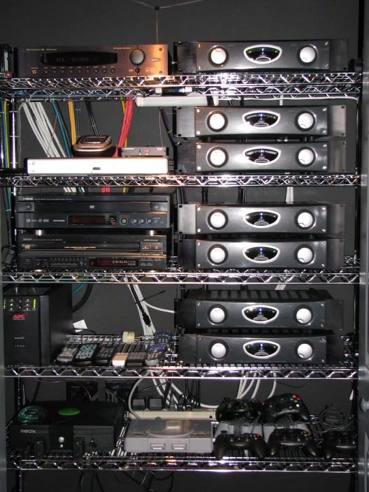

Like this :D
Woah, it may take me a while to get there. haha
