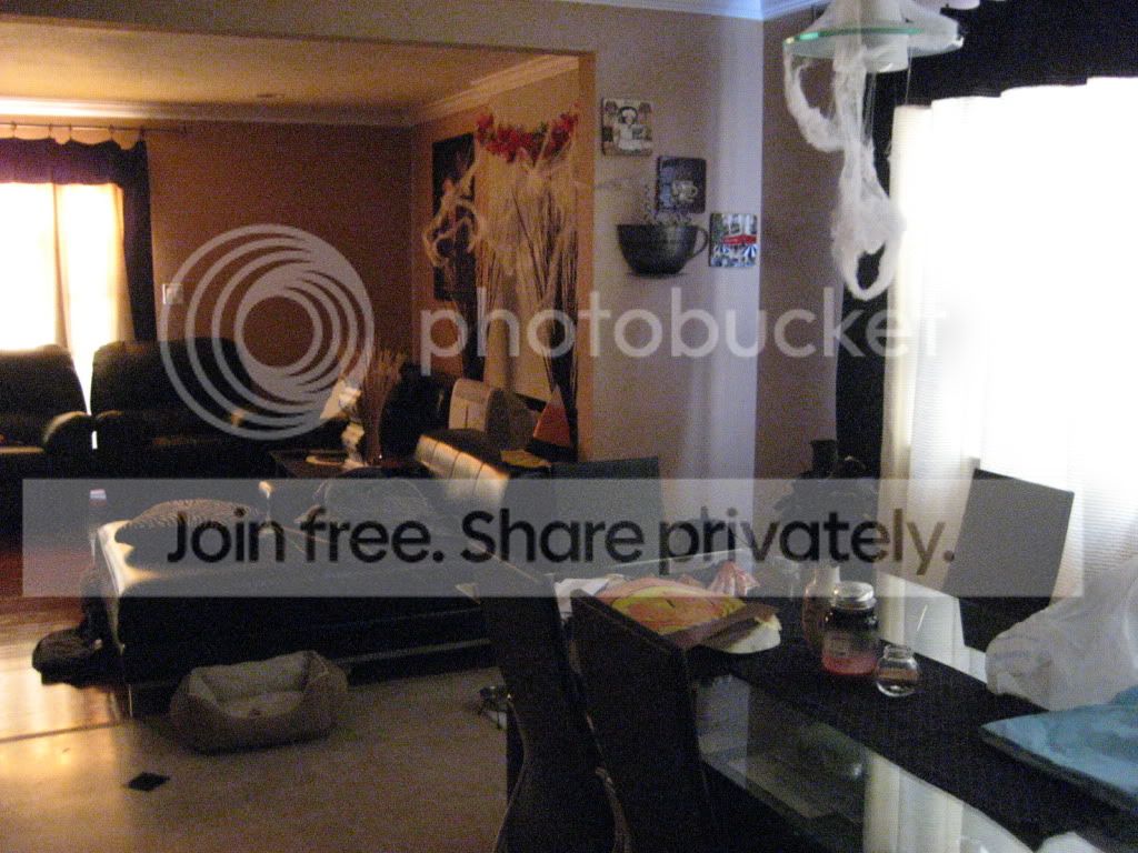

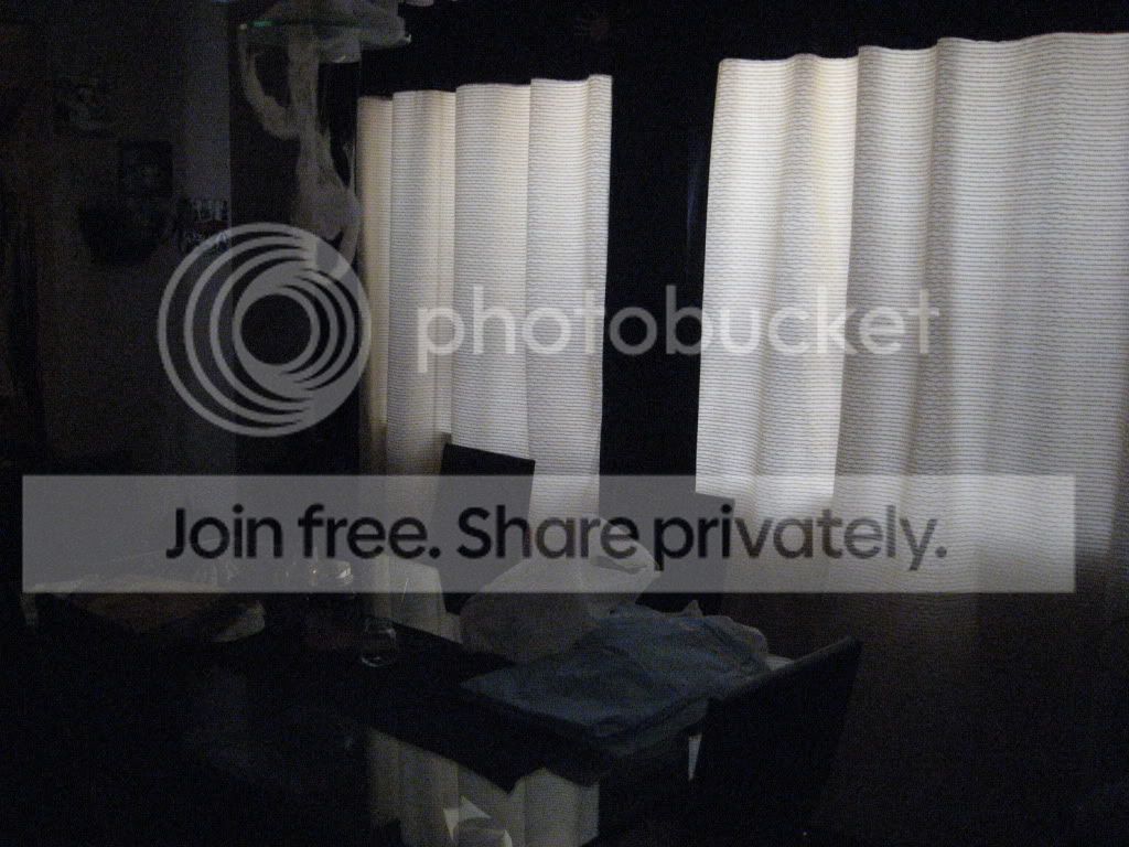

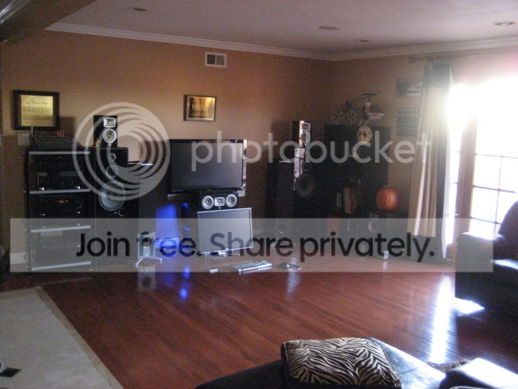

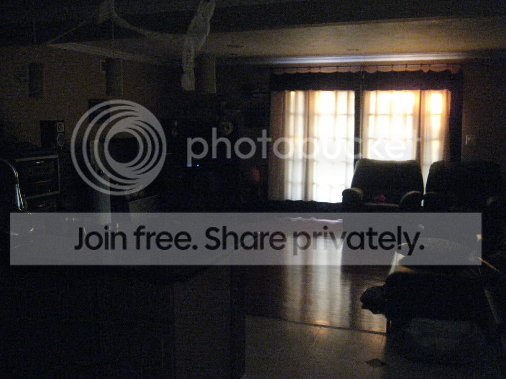

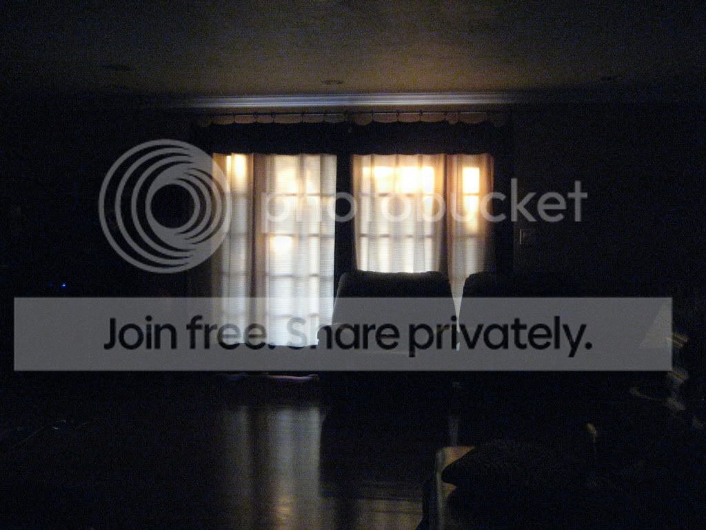

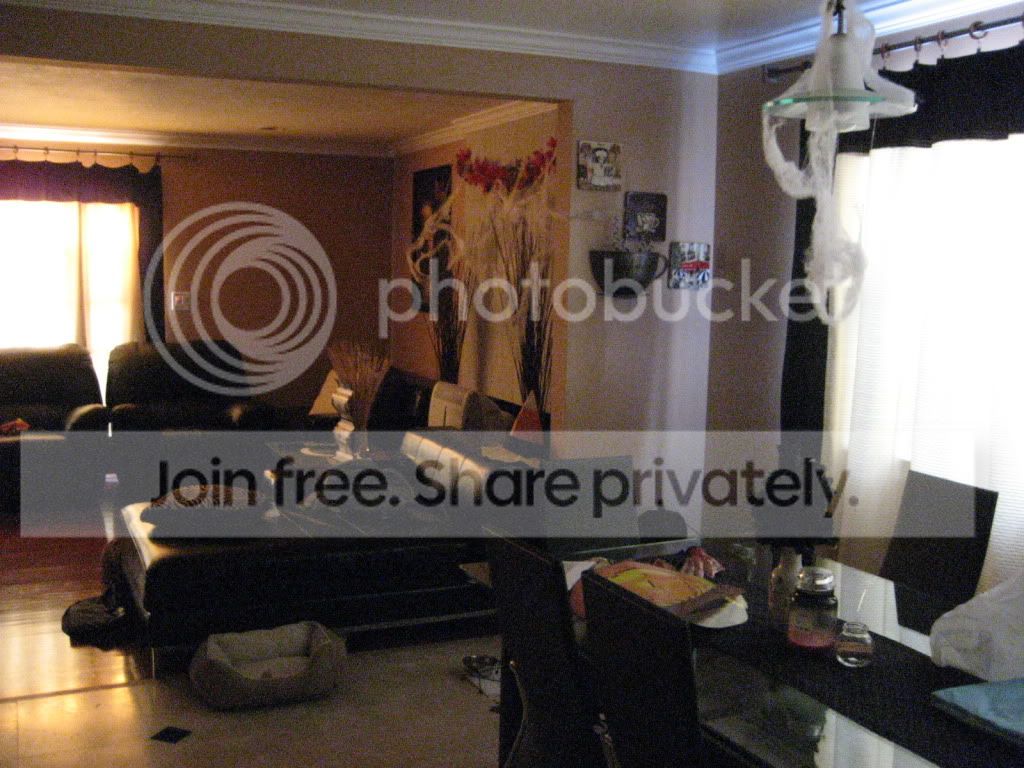

The best way that I can put it is that, IMO, the underlying technology doesn't really matter. There are some LCDs that are better than certain plasmas. And there are some plasmas that are better than certain LCDs. To me, it really all boils down to specific models. It is also a matter of certain strengths and weaknesses and matching those attributes to your specific viewing conditions. For example, if your room is well-lit or bright, I would suggest avoiding any display that has a glossy and/or reflective screen. It doesn't matter if it is LCD or plasma. There are some LCDs that have very glossy screens and there are some plasmas that have very glossy screens. Bottom line is that a glossy screen in a well-lit room equals a distracting and unsatisfactory viewing experience to my eyes.

So the top two brands happen to be plasma. But that does not extend to mean that ALL plasmas are better than ALL LCDs. At the moment, if you want the absolute best, get one of the remaining Pioneer Kuro. If you are ok with a very close second and your room is dim or dark, then a Panasonic plasma is the next best choice.

If your room is well-lit or bright and you cannot afford one of the 60" Pioneer Kuro plasmas, I would recommend the Sony W5100 LCD. Sony uses a very effective matte screen surface that is excellent in a bright room and their 65" W5100 model is reasonably priced for such a large LCD screen size.
To sum up:
- Get a Pioneer 60" PRO-151FD, PRO-141FD or KRP-600M if you can afford one.
- if your room is dim or dark, the next best choice is a Panasonic plasma. The 65" TC-P65V10 offers more user controls and a 96 Hz mode for 1080p/24 content, but if you need a lower price, the TC-P65S1 gives up the 96Hz mode and the extra user controls, but a professional ISF calibration can make it look just as accurate as the V10
- if your room is well-lit or bright and you cannot afford one of the Pioneer Kuro plasmas, I recommend the Sony W5100 for its excellent matte screen surface and generally very good picture quality and reasonable price given the size.
