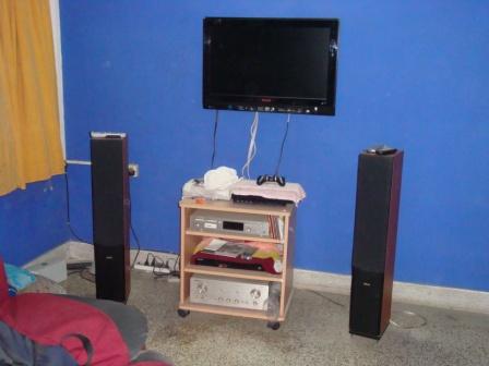

Most of the SS amps have < 0.5dB of deviation in FR from 20hz to 20khz. Speakers have easily 10 times more variation... And the room will easily add another 10 times deviation over the speaker's. So the warmth/brightness thing you mention is mostly the room and speakers. In the end, the amp has
very little to do with it. Just think of easily 10dB variations from room speakers, and <0.5dB from the amp...

You could do a lot more improvement by playing with placement, adding room treatment, changing speakers, etc...

Are you 100% sure that's the amps fault and not the speaker's? Got a pic of your setup?

Or, my advice, buy something with good return policies, and do a blind test yourself. See if you really hear a difference. While I don't doubt that the Dyns are good speakers, they're probably your limiting factor here. I like Dyns, but if you compare their line, I believe their Audience line is their budget line. Going up the line would give better sound quality. Floorstanders often do give you better bass, but the Contour line and the like would probably be more what you're looking for... Anyhow, my guess... Maybe the Marantz really has trouble with the 4ohms and 86dB efficiency of the Dyns in your, possibly large room... I don't know, but usually speakers and rooms is a lot bigger issue than amplification...
