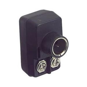

Hi, JC. Will the FM antenna that connects to your JVC also connect to the Samsung? I see that the Samsung has a 75-Ohm coax connection, but I don't know what your JVC uses. If the older antenna will connect to the Samsung, I'd say give that a try because it might be a better antenna. My older receivers came with better antennas than my newer ones, at least in my opinion.
If the older antenna connects to the JVC with two wires, then you could connect it to the Samsung using an F-type balun like the one shown below. Of course, this would be most useful if you have one around the house to try out. :)

That item Adam suggested is sometimes called a "balun" and allows a 300 ohm dipole antenna to work with 75 ohm inputs. With that, something like this is a possibility, but should be available locally for a bit less.
That's the same one that I was looking at, too. :) I have at least one like that, probably from Radio Shack back in the 80s. I'm hoping that the JVC is old enough that it came with one similar to that (but it probably won't be as thick). I think that my older receivers came with dipole antennas like that, as opposed to the single wire variants that showed up afterwards.
