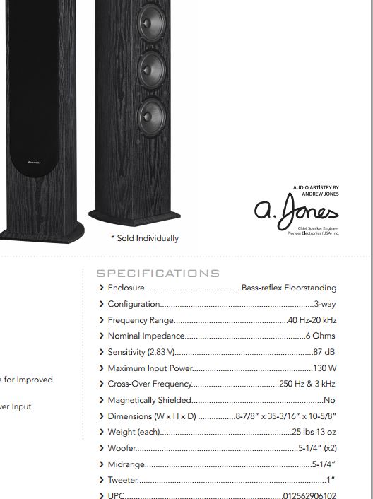

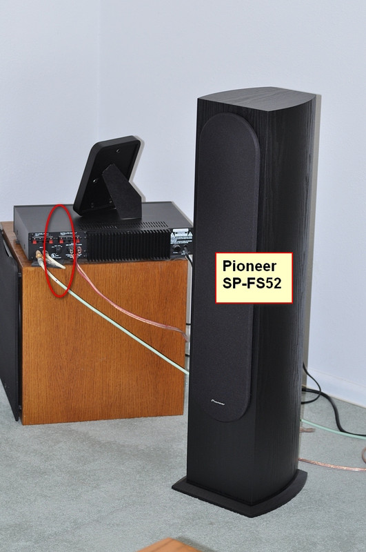

I have setup my new refurb Denon 1712 with Pioneer SP-FS52 fronts and Pioneer SP-C22 Center channel speaker. For the time being I'll have to use the old Polks that are still mounted on the wall for rears till I can upgrade them to the Pioneer SP-BS22 rear. I'm going to do the Audyssey setup and need to know where to set the crossover on a 20 year old NHT MA-1A/SW2P Powered Subwooferr. My choices are 50Hz 80Hz 110Hz or BY. I have attached the specs of the front Pioneer SP-FS52 speakers below.
Any suggestions?

BY stands for bypass, you're going to want to use this. Since you are using the bass management on your receiver it will be your crossover so the subwoofer doesn't need to use one at all.
