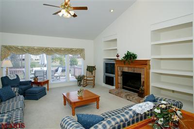

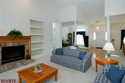

Here are two pics showing the room
Thanks for the advice so far, I really appreciate it. I have attached two pics showing the room. I will probably be buying a rear proj 50"-55" that will be placed where the rocking chair is in the corner (by the way, we just bought this house and this is the current owners furniture, so hold the jokes). I'm not sure I want to go with surround at all b/c of the large vaulted ceilings. I just feel the sound will get lost.
Plus, I am going to finish the basement in 1-2 years with an overhead proj and surround with a much larger budget. Therefore, I am just wanting something to provide good crisp sound for TV and movies in this room, nothing mind blowing (obviously by my budget). Maybe 2 bookshelves, a good center, with a good sub would be my best option for this room. Any thoughts after looking at the pics?
