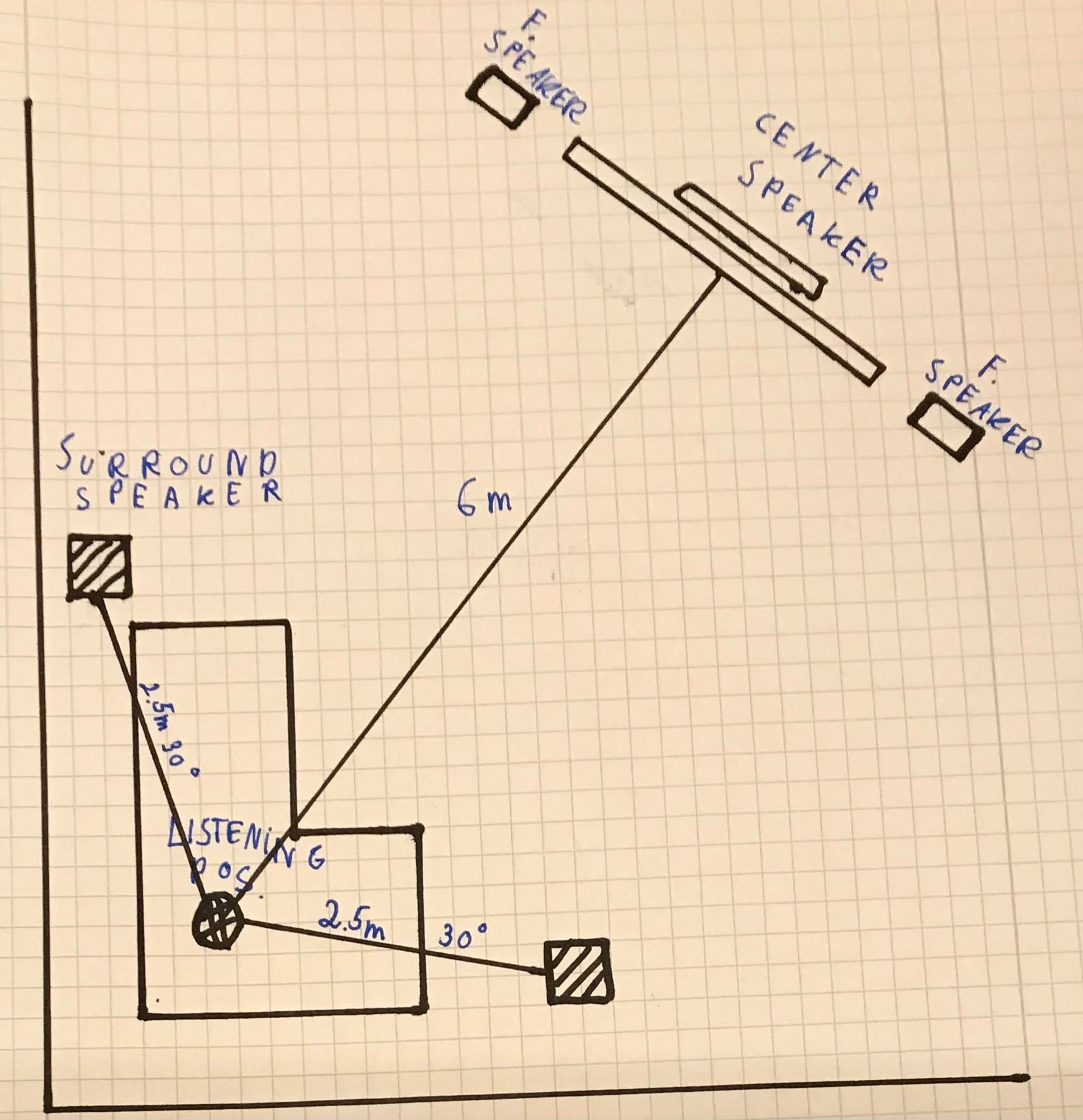

I´m not sure if my setup that I want will work with this placement of speakers.
The back speakers are at 20 (on picture I put accidently 30) degree angle from listening spot, will that butcher the sound completely?
Also from the center speaker the distance will be 6 meters/19 feet to listening spot, but 2.5 meters/8 feet from the back speakers to listening spot (Can`t shorten the distance from 6 meters/19 feet unfortunately).
The back speakers will be approximately 0.3 meters/12 inches away from wall.
I will also do audio calibration with receiver, but would this setup work in the first place?

Speakers:
2X Dali Oberon 7 floor speakers (Front)
2X Dali Oberon 1 bookshelf speakers (On a stand, little higher than listening position)
Dali Oberon Vokal (Center)

Well..... do you have a plan B? Lol
I see nothing but a whole lot of reflections in that corner. From super exaggerated bass to interactions with ALL the speakers. You definitely can install it as such, but acoustically will be a mess.

I do have actually plan B :)
I would have to make some changes in room, but I can do another kind of setup for sure.
I will draw the new plan up in few minutes, and btw thanks for such a quick answer :)

You can try your set-up the way you have it, as can always adjust things around for your environment. It will require some experimentation, in your case. Move the viewing distance up some, for example, so the right surround is a bit behind your ear as would the left speaker.
Again, go with what you have have drawn and go from there. EXPERIMENTATION! See what your AVR will do with the Auto Calibration at different speaker locations and moving furniture.
