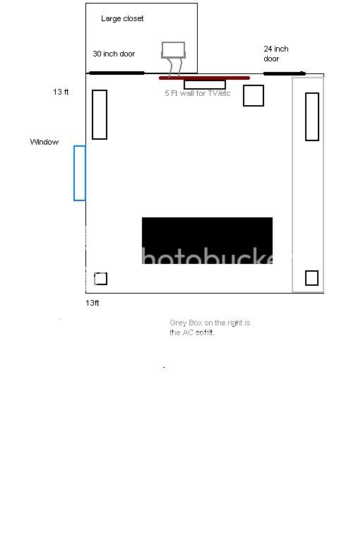

The room dimesions are 13' x 13'. Here's a diagram for easier understanding

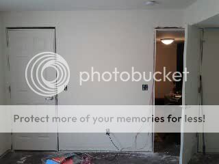

Ok. I've run most of the speaker wires underneath the baseboard already. I cut a 1 inch slot at the bottom of the drywall, and I am running the speaker wires into the closet and then I'm putting the baseboard back on. As you can see from the diagram I have to have my floor standing fronts a bit away from the wall due to the door for the closet. These walls are exterior walls, so there's no way to run the speaker wire in the wall without cutting and repairing drywall, and I'm just not at the point to tackle such a project yet. So I thought this would be the best option. Raceways were my other idea, but they aren't as clean looking and I'd spend $100+ to get what I need. Will I be fine running them the way I did?
Second. I bought monster XP cable. This was before I really read anything, and I can't take it back (store closing). So I have 100ft of it ran already. Its 16g (which I was able to find out from searching online, as it doesn't list gauge size on package), and I have two runs right at 50ft (max for that gauge I've been told). I had used the same wire prior to moving everything to this room, and it sounded great. But the runs were 15ft, not 50. Is this going to suffice, or am I needing to waste $50 of cable? I can shorten these cable runs by 15ft, but then they wouldn't be hidden, as I'd have to run them across the floors at the door jambs.

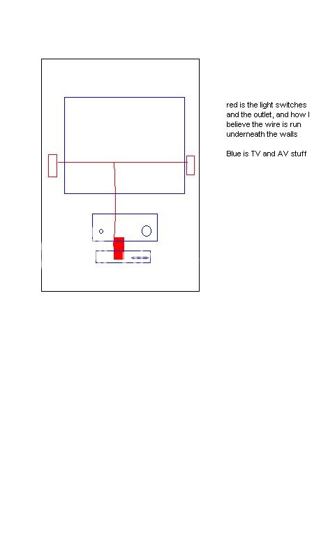

Third, I plan on having most of the cables, residential gateway (uverse), power management in the closet. I plan to have the receiver, cable box, PS3, and wii sitting under the TV. The only issue here is on that 5ft wall for the TV there is a power outlet 1ft from the floor. The wire for this drops down from 3 feet or so. Will this outlet cause me issues if I buy a power management system with filtering abilities? Wires are going to be coming through this wall to the receiver at about the height of the outlet. So I'm worried about interference, should I be? Should I move this outlet? should I move the receiver into the closet?

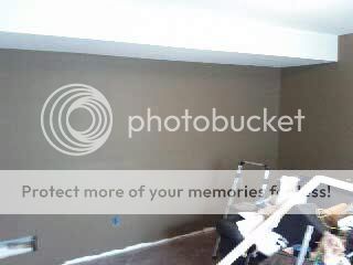

Lastly, paint. I keep reading I should paint the ceiling and TV wall black, etc etc. Is an off-white flat paint on the ceiling that horrible? I plan to paint the room in a dark brown, but had no intentions of painting the ceiling. I have this HVAC duct soffit on the one side that I planned on painting to match the wall.
