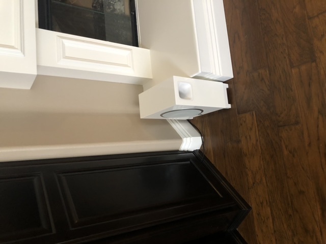

Yes the Focals have an adjustable tweeter that I have pointing into the direction of the main seating area. I have an in wall passive sub but haven’t gotten that to work. I did have the sub adjacent to the couch however moved it next to the fireplace. The focal sub is low profile donor fits. But I don’t know how to assign the ceiling speakers to a particular channel. With a center Channel speaker under the TV, perhaps front left, front right, surround left, surround right, but then what do I do, what channel do I assign the front ceiling center and the rear ceiling speaker and how does that translate to my 5.1,7.1 configuration?
