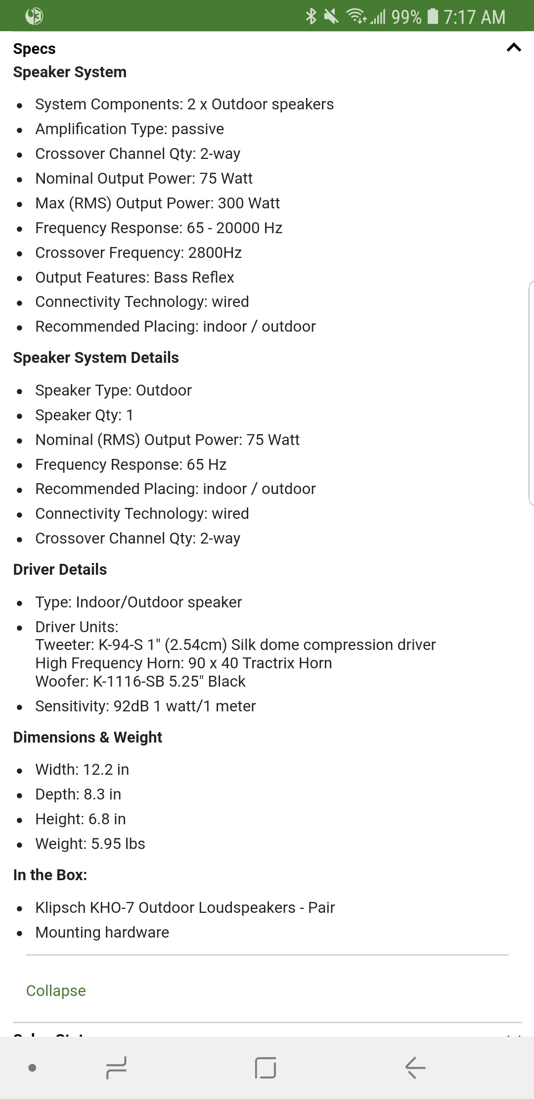

Here is a screenshot of the outdoor speakers from woot. I had the sensitivity wrong. The method I read was to use 103 dB as a baseline and double the watts for every 3 dB.
I had to guess on the sensitivity for the other two sets. They are in the wall and I only saw the brand name when I pulled off the cover. It's a Bowers Wilkins and one of the circle ones at this link. http://m.bowers-wilkins.com/speakers/custom-installation/In-Wall-In-Ceiling/In-Ceiling. I opened each one and looked again and most power suggestion ranges from 25 - 130 W. I may have to find something a little stronger for those.

103dB as a baseline for what? Yes, a doubling of power would yield 3dB additional spl. 103dB would be an extremely sensitive speaker, or a very loud spl level. Many speakers are in the mid to high 80s for sensitivity in any case. You realize that 25W is just a minimum amp power recommendation? Still depends how loud you need at what distance for the most part. Try using one of these to get an idea of your amp needs http://myhometheater.homestead.com/splcalculator.html
I do like that used Sonance amp idea....
ps You realize also that speakers don't "output" watts....that's badly worded spec you posted in the pic.

The site said 103 is what you would hear at the movies which is plenty loud for me.
I'll check out the home theater link. Thanks!
Movies are generally calibrated for 85dB average level with allowance for 20dB peaks (plus 10dB more for LFE channel). If you have a phone download an spl app for an idea of what your listening levels are....
