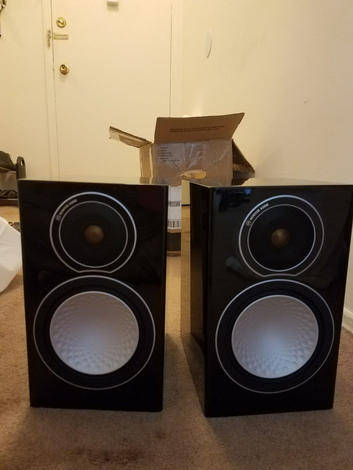

I got them in ebay auction from wholesale seller listed as new other. Due to price my first question was to find a way to check if speakers are actually legit.
Thank you very much for suggestion to add same speaker as centre. I never even knew or considered this option before. This might be more economical for me as any one with one speaker would propably offer it for less than half the price of pair.
N
naga
I finally received speakers and listened to them on weekend. For short time i tried they actually sounded pretty good.S/N number on speakers is 700867. If any one has experience with previous monitor audio products please let me know if serial number is inline.
