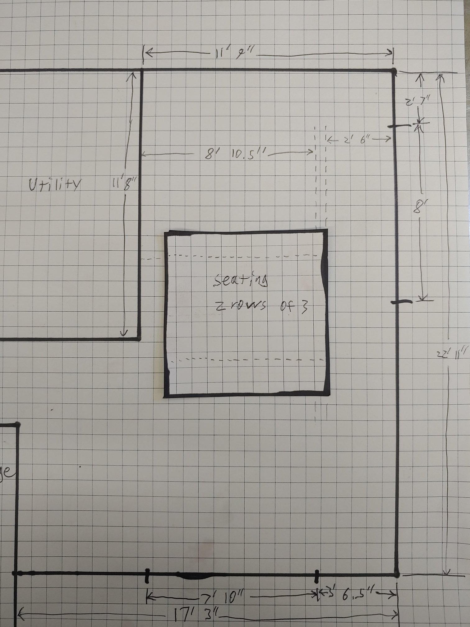

Hey all. I'm in the process of upgrading my home theater to a 5.2.4 system. I plan on having two rows, each seating 3 people. I have Infinity RS4 towers for front left and right, an Infinity Alpha 37C center, a Klipsch Sub-12 (will be adding a second one when I find one used or on sale), and Infinity HTS Satellites for rears and overheads. I have a bit of a dilemma with rear placement, however, as I don't have a wall to attach them to on the left (facing TV), and I don't want to attach them to the ceiling as it would probably screw up my Atmos soundstage. Also, if I attach the right rear to the wall, it will be 30" away. There will be about 10" of space between the seats and the left wall, 30" of space between the seats and the right wall, and the back of the rear row will stick out past the left wall corner about 31". This is in the basement of a split entry house built in '99. The patio door on the right wall gets used a lot, so we need to be able to readily access it. Aside from building walls (not an option at this time), how would you mount your rears, and where would you place them? Btw, the dotted lines in the seating area are approximate head location, the TV is on the 11' 9" wall.

The front row of seating my guess will be the main row.
I would put the surround speakers on the side wall if possible as far back as you can on the utility room wall and match that depth up on the exterior wall for the other right surround....yes, the left speaker will a short distance to the person.....I have something very similar...if your AVR has a room correction software built into (it will note the distance of all the speakers to the MLP and normally one or maybe two other seating locations.

I'd like to retain some semblance of surround for the 2nd row. I'll be building a riser for the second row and and wondering if attaching the speakers to it might not be a good idea. Alternatively, I could put them on the back wall with the 7" 10" window, but that does seem like a pretty big distance and I'm not sure how that would affect the sound stage either. My receiver is an Onkyo TX-797 and yes, it does have room "correction" software.

Best position...yeah I didn't realize the dashes meant positioning of people...maybe something on the floor on stands....the back edge of the riser.
As a general thought...this seems like it will be a nice family entertainment area. I have the exact format you're looking to achieve...5.2.4...imo the most important part of this is 5.2 because this will be 90% of the content. After looking at your drawing again...A short wall or two non-load bearing columns on the back corners on the riser and mount them there, or bookshelves on stands seem like your best options. The back wall is too far back.

I agree, there really isn't a better area in the house for it. I'll definitely be adding that back wall to the riser. The question is, do I carpet it, or paint it? My gut says fill it with rockwool and carpet it. Also, since I'm going that route, would it be a terrible idea to buy a pair of Infinity RS4 towers, RS2000.4 towers, RS1 bookshelves, or RS2000.1 bookshelves to use as my rear surrounds? I'd still be using the Infinity HTS satellites for overheads.

If the floor has carpet...that would work great....if the floor is something other than carpet, that's still not a bad option. A relatively cheap option would be drywall, but then you'd need to finish and paint it...another option is a beadboard type material.

The floors are carpet on concrete. I'll be carpeting the riser for sure. The back wall on the riser would likely be drywall. But maybe with carpet on the side facing the seats.

Carpet with a good staple gun might be the easiest.
Speakers....I still don't have a firm opinion on them, seems like many of the reviews were mixed...but on the question of larger surrounds...you don't need them really, but why not? If you ever get into multi-ch music...the surrounds can get a full range signal (to the point the sub takes over)...I like my B&W floor standers better than the RBH book shelf as surrounds.

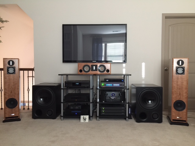

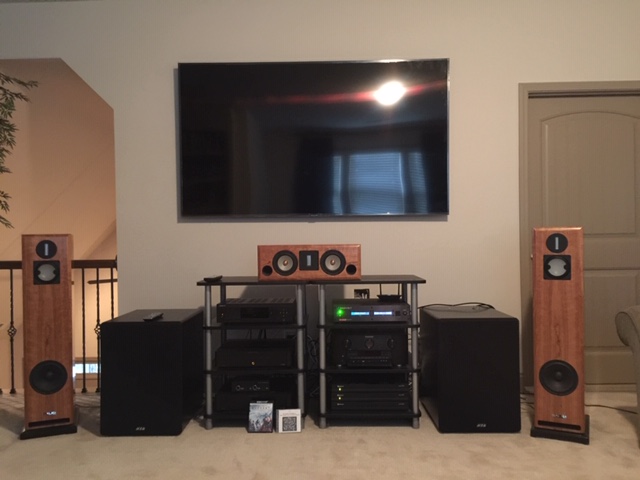

My space is 18'x16'x9' and open to other areas of the house.
Two 15" HSU...grills off
Post TV upgrade...grills on
Maybe the two Klipsch subs will suffice for you, but if you feel you're turning them way up for the impact you want...you know you're ready for an upgrade.
