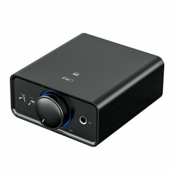

If you want a device that both measures well and is excellent for high-impedance headphones while staying near your budget in the current (lots of shortages/high prices) market, you may have to chart to waters of bay of the E
like this device:
ASR Review:
