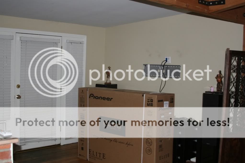

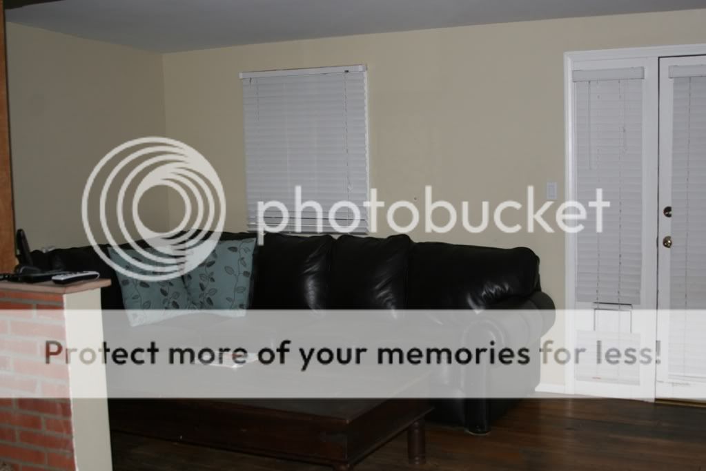

I wanted to thank you all for your input! Great ideas here. I took a couple of quick shots of the room where this will all be happening, feel free to browse and opine if you'd like.

Ok, so 5.1 seems to be the way to go with my layout. I actually thought of moving the couch forward, but getting anywhere close to 5 feet wouldn't work (perhaps it's time to replace the couch...;)) I could probably get 2 feet or so, just barely enough room to stuff the bookshelves in the back on their stands. Not ideal imaging I'd suppose?

It's looking more and more like getting those c2's up on the walls or behind the couch. Based on the pics above, perhaps one good sub would suffice?
Is it even feasible to wall mount bookshelf speakers? That was my concern with using that type of speaker for the surrounds, with placement, etc.
Pay no attn to the wall mount currently up on the wall. The panasonic that I retired used to be hanging there. I'm still shopping around for a decent mount for the pio - can't decide what to get, besides, I've got a week to kill anyways since I'm currently running the wonderful and ever so colorful break-in dvd.

Wow, thats a tight space! Thats a nice size screen for the space.

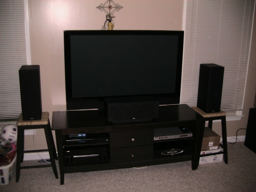

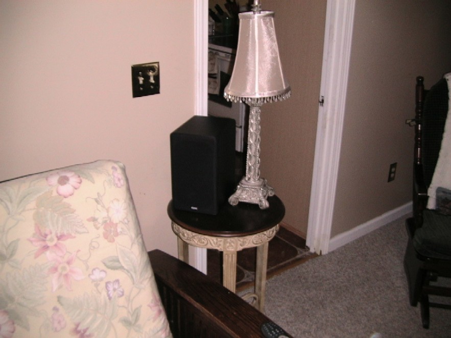

If I were in your position I would sell the two sets of energy speakers and get the system I have SVS SCS-01's (all the font the same) and SBS-01's for the rear wall mounted with PB12-NSD. Except with that layout you will probably have to go with 5.1. The speakers could mount on the walls to give you more room for the sub. These speakers are just awesome for HT check out the reviews and here is their website http://www.svsound.com/products.cfmWould cost around 1,000 to 1,400 shipped. What is your buget

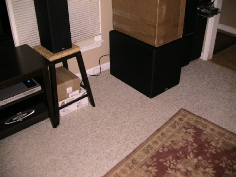

Your biggest issue is finding space for the sub maybe it will fit in that front left corner, can't see your box is in the way;)
For my pics don't pay attention to the extra boxes, that is my old system ready to go out the door:D Oh and the wires have yet to be hidden as I want to balance the room out before I do that. It can be hard because you have to get the wife and kids out of the house while you work:rolleyes:
