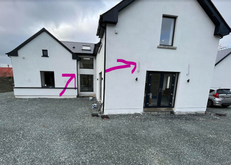

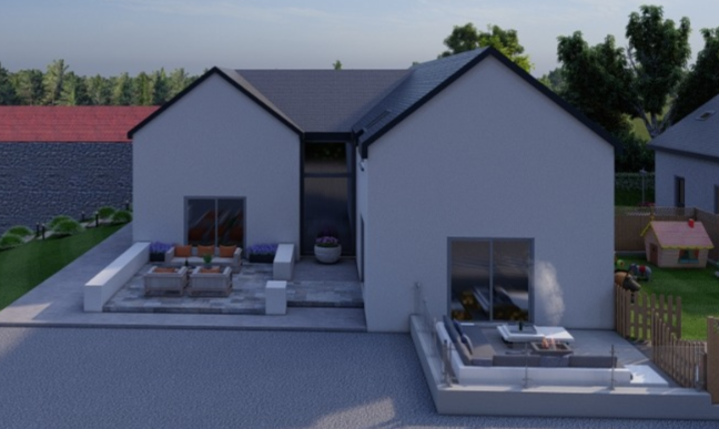

I'm currently at the final stages of our house build, and am just looking for some advice on selecting outdoors speakers. Our home is going to have two patios, each connected to the east-facing gable ends of two separate buildings (3D render attached).

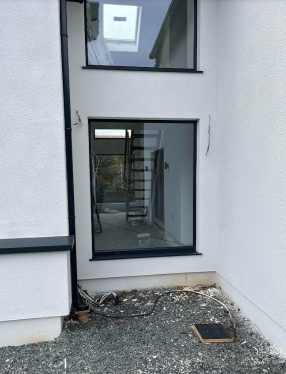

I'm looking to install a pair of speakers (left and right) for each patio. We've already run the QED speaker cable, and here's the configurations we're working with. Each will have its own set of stereo speakers, with cables for each pair running back to a central location where I plan to have amplifiers in the future. You can see the cables sticking out over the double doors on the back patio, and over the picture window where the front patio will be.
Both patios are outdoors and exposed to the elements, though they may be partially covered in the future. The speakers would be used for casual listening, gatherings with friends etc, so I'm looking for speakers that provided clear, balanced down and hopefully blend well with the house. Also (not sure if this is relevant for speaker choice but...) each cable runs back to the A/V rack room individually so we could do a multi-zone audio setup for the two patios, but in practice, I think they are close enough together so that they'll probably always be used as a single zone.
View attachment 64061View attachment 64062
