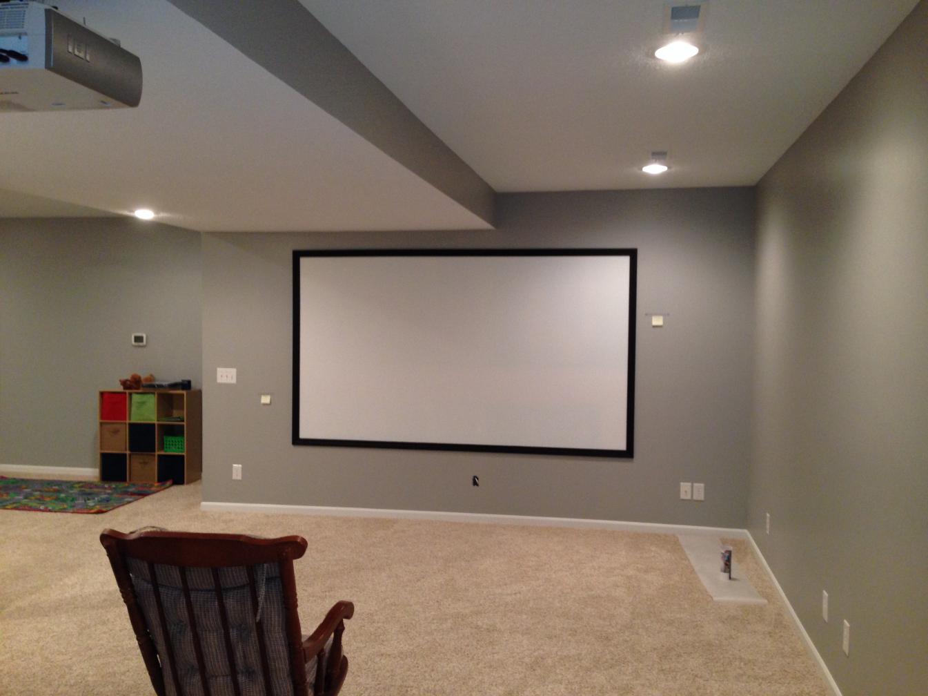

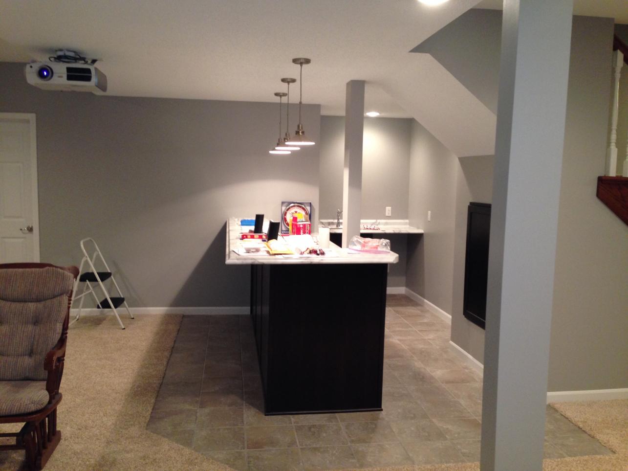

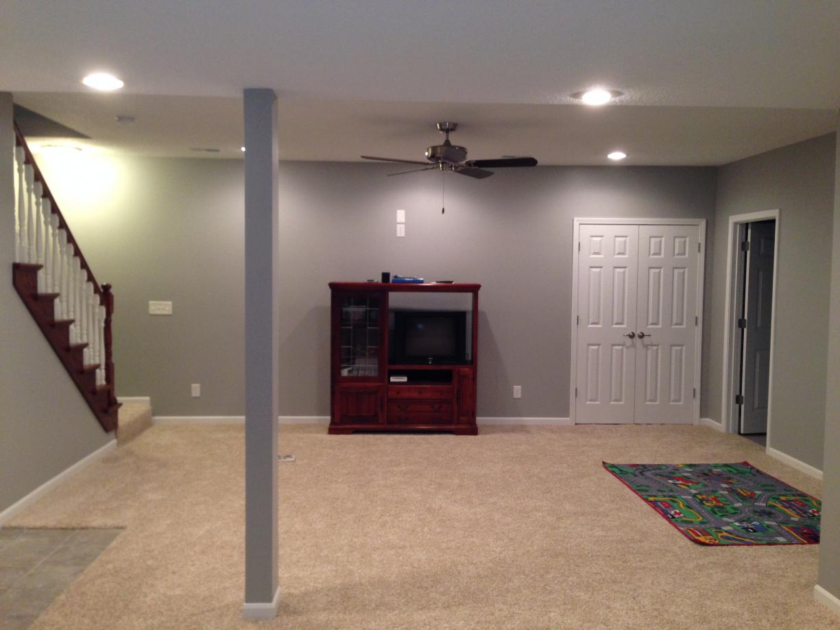

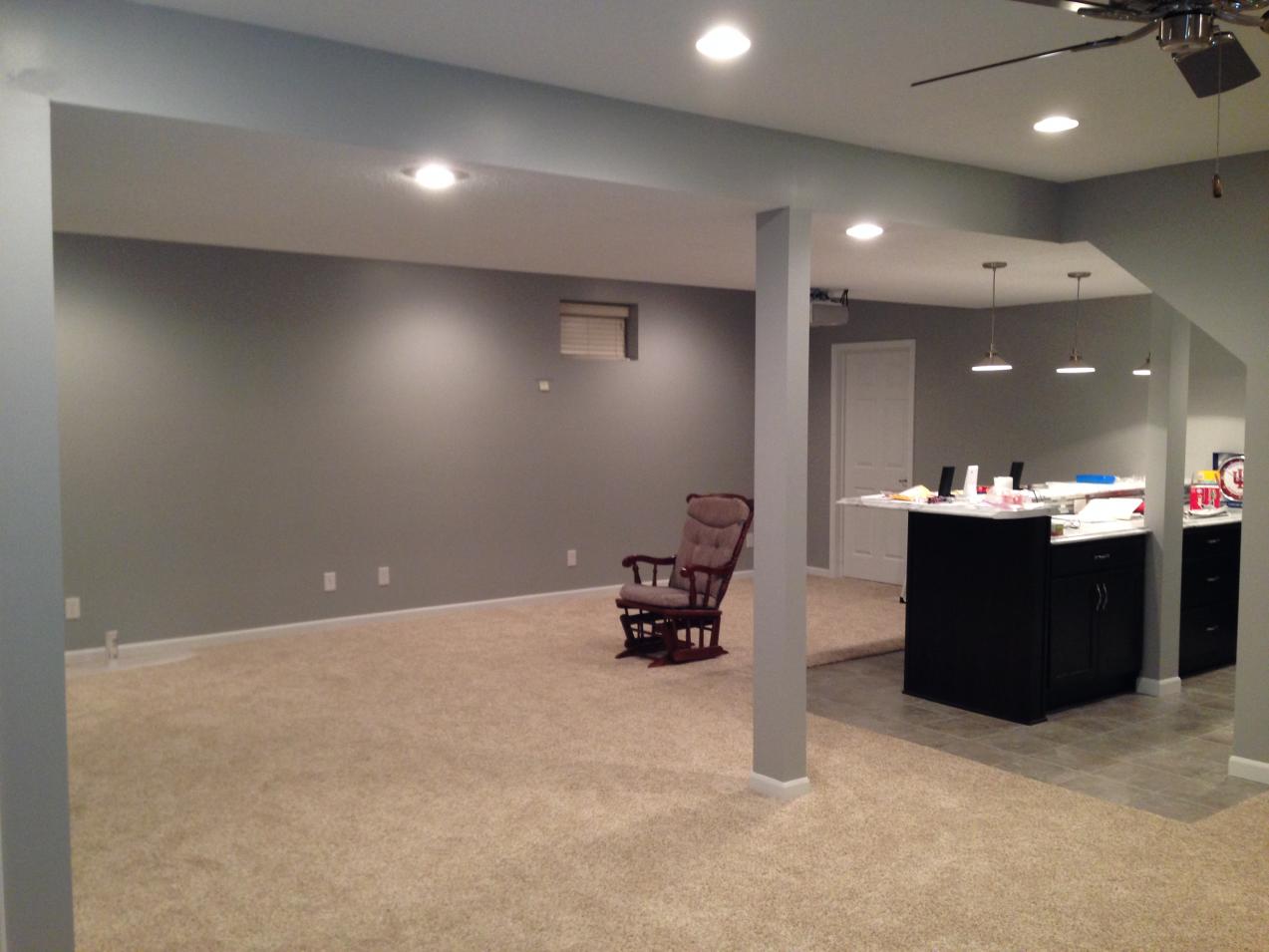

Need a sub to fill 3,000 cubic feet on a budget of less than $500

Two more questions related to my space.
Do I need to be concerned about what specifications the floorstanding speakers have in a space this large?
If I went with the Outlaw LFM - 1 EX or the Rythmik LV12R could I get by with bookshelf speakers for my fronts or is the space to large? If I could get by with bookshelves what would be recommended in the range of $300-500 for the all three, L/C/R?
Thanks everyone
Oh, absolutely!
Keep in mind that speakers don't have to "fill" the room. They just have to reach your sitting distance. That's why we can use speakers OUTDOOR.
The subs are more dependent on room size, not just sitting distance.
