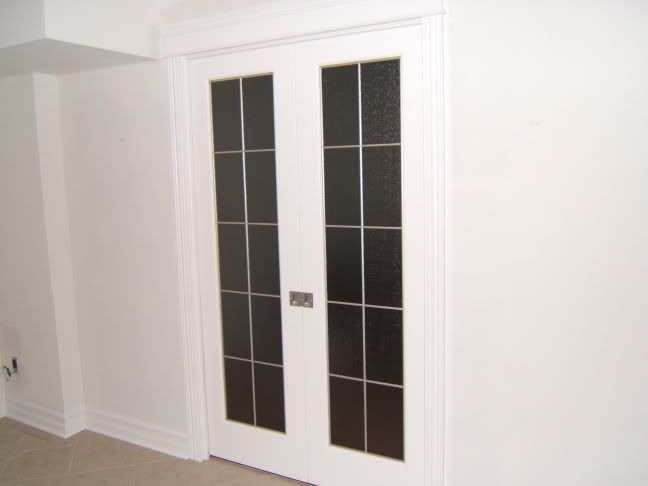

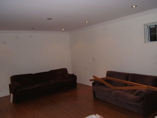

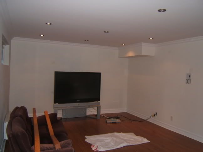

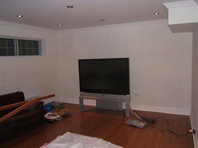

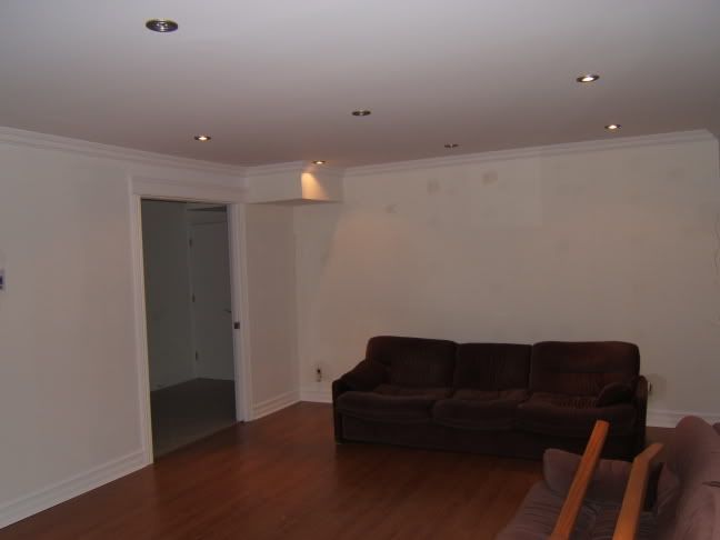

Thanks for the great site, I have leart a lot from here...but I want something tailored to my needs...I just built a cinema room, where i could go relax, unwind, watch a great movie, some tv or just go and play a good game on the upcoming xbox 360 (15 days baby)...anyways I already have a decent HTIB (JVC, forget the model number, but 700W total, purchased 1 year and a half ago), although I like the sound, it could be better as the room is now enclosed, I would like to have a GOOD soundsystem...now what woudl you reccomend me, I would like to keep this as cheap as possible, money wise, but get the most out of my money...something around 700-900$ CDN would be about good...a 6.1 system would be very nice, but suggest me...here are some pics of the room, and my new 61" Samsung DLP (I just got her today :p )
