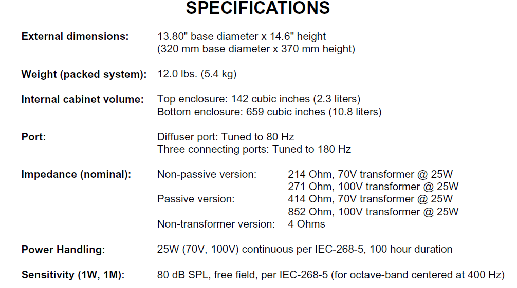

The Freespace 360P series II seems like a very different animal, that is not 4 ohm, and for that model, high current is not as important as high voltage. It is hard to find things on the Freespace 360P but I did find the following linked one, is it what you have?
If it is, then a 100 W 8 ohm amp will definitely be adequate as those speakers are rated only 25 W but there are the transformer version and non transformer version, so which one do you have?

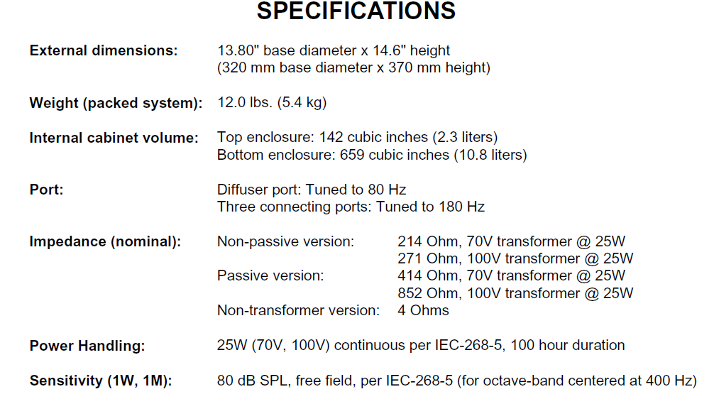

Originally I saw a slightly different spec sheet and just now another slightly different one here https://assets.boseprofessional.com/m/1f08a3dab4a081fe/original/tds_FreeSpace_360PII_ltr_EN.pdf altho minor differences....
