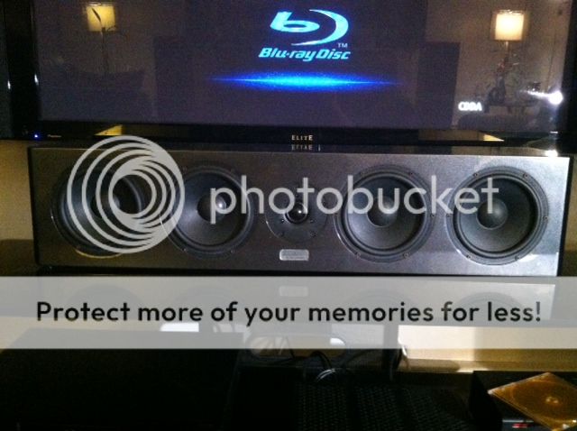

I think I am on my 5th or 6th center. This is the one I like the best, which is a W(MTM)W design.
You say that now. Give it a month, I bet you hear one you like better :p
I know. Don't forget who turned you on to that one.
Now down the road I might even do better then yours, as you know I just my new system. When I get something I am already looking for my next purchase which are going to be these http://www.cinepro.com/BFM_9-18-10_BLK.pdf and you know sooner or later I will be owning these, mostly later then sooner. I can't wait. I told John that the Evo2's where on the top of my bucket list and now I am good for speakers. He said not your not, you'll be, once you get the BFM system. Means I got to live a little longer.
