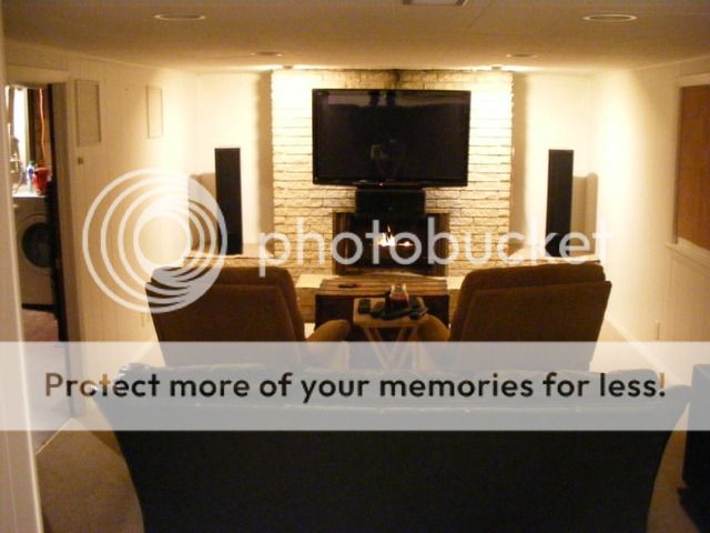

I thought this turned out cool! My wife has her everything room, including surround sound, computer, and I bought her for these cold winters in SD, a electric fire place that comes with a very attractive mantel. So I just place the flat screen Tv on the top surface of the mantel.
Now if you look straight ahead your eyes would focus somewhat between the matel above the fire box, so we find our eyes raising up slightly and no neck problems. It worked out great. But with that said I would perfer looking straight ahead, but watching her 40inch flat, you adjust very fast and for get about the slightly up view.
