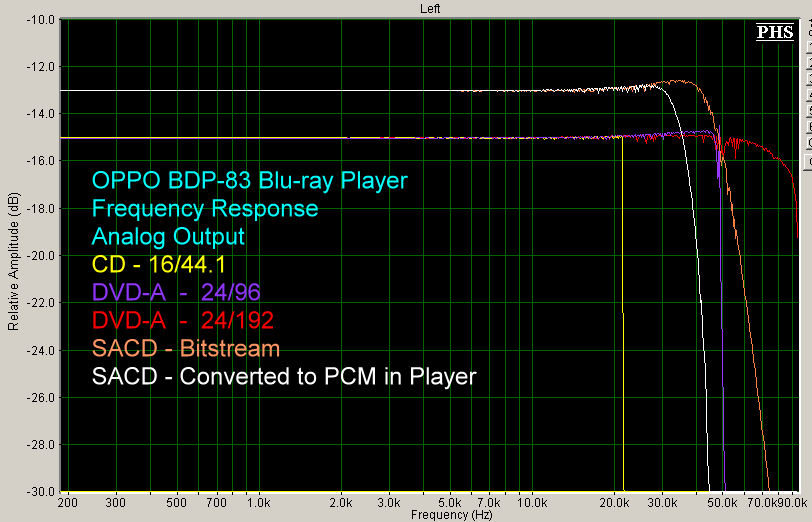

I wonder why the measurements for the regular BDP differ markedly from the measurements presented in the hometheaterhifi review
http://www.hometheaterhifi.com/images/stories/2009/june-2009/oppo-bdp-83/oppo-bdp-83-blu-ray-player-fr-cd-dvd-a-sacd-analog-output-large.gif
In their measurements, there were NO unusual peaks for DVD-AUDIO 24/192, only very slight peak of 0.5 db. No peaks with HDMI.
So which measurements are correct and why are the differences?
Also, were these measurements only for analog out or HDMI out?
http://www.hometheaterhifi.com/image...tput-large.gif
As the article clearly states both in the page title and content, these were analog measurements. You can NOT measure analog audio via HDMI.
There are several possible reasons why their graph doesn't agree with mine:
  • they set their speakers all to small. You can't tell since their graph cuts off at 200Hz
  • they set only some speakers to "Large". Maybe this only occurs with all speakers set to large.
  • they tested an older firmware player. My player had the latest firmware update.
It's hard to discern anything from that graph considering they didn't document their test conditions and they only tested 1 channel. Oppo has already confirmed all of my findings and working on a solution.
Thank you.
