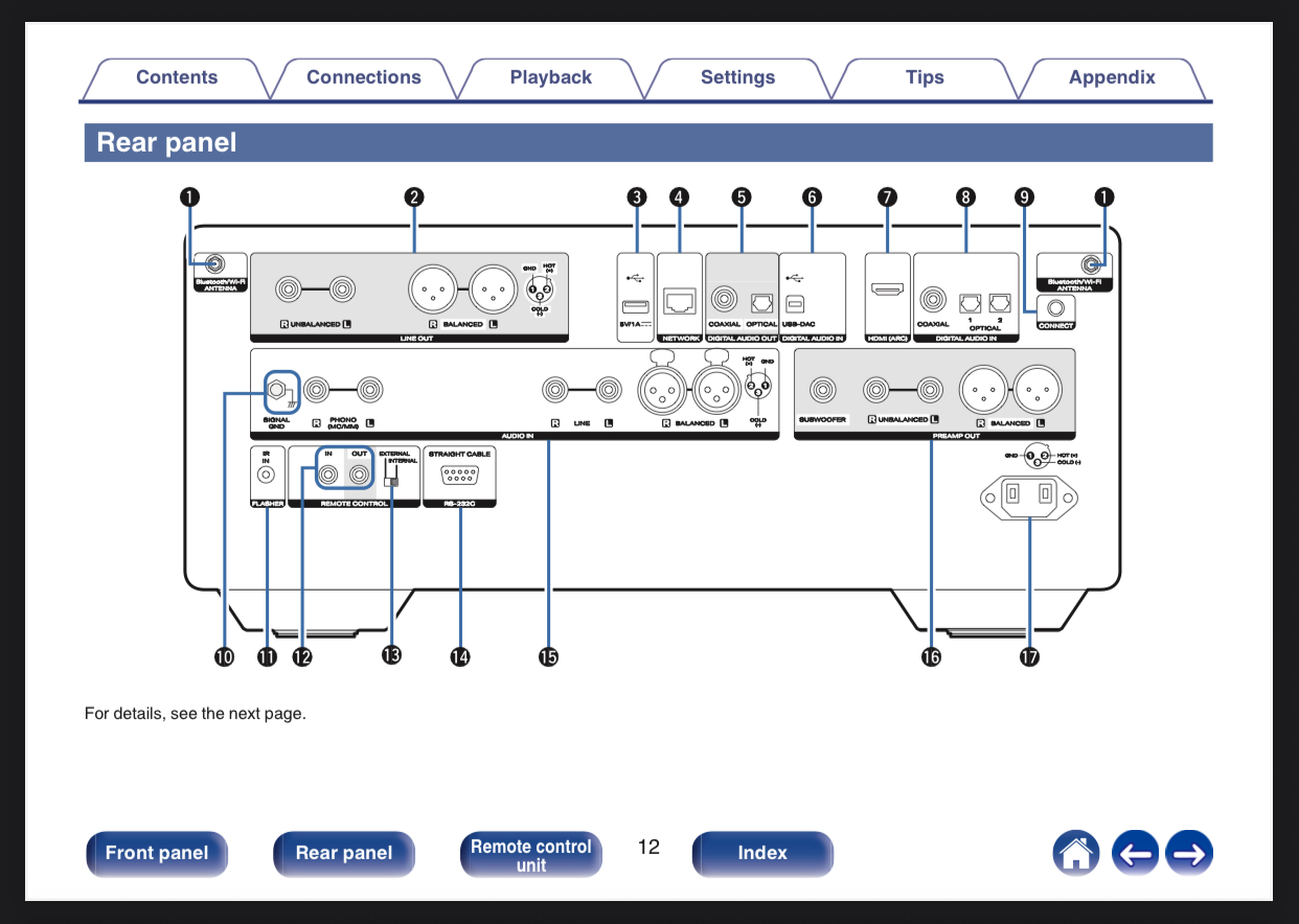

Not having a trigger output to turn on a connected power amp is absurd.

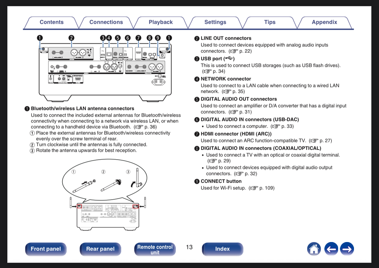

I see it only supports ARC and NOT eARC. That is a serious oversight if trying to get the best SQ from your TV. Watching the BPO digital concert hall for instance which supports lossless audio.
