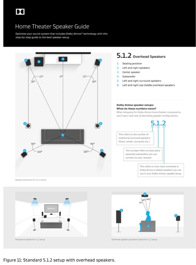

Change expectations and do 5.1.2.
Putting rear surrounds on the back wall where the couch is against it is very distracting imo, but people do it. Also. The rear top/heights should be behind the listener for proper front to back overhead panning. I’ve seen .4 overheads with the couch against the wall in a top middle front height designation, but Atmos is not designed for that so imo, 5.1.2 is the best choice. Maybe find another room? Can’t move the couch ahead? What’s the room dimensions?

Here’s Dolby’s guide for 5.1.2. It looks like they’re indicating to keep them in line with the mains, but that’s not really the case. How tall is the room?
What brands are available to you? What country are you in?

My room is 2.40 meter high. my LCR are monitor audio i don't have any problem to purchase internationaly
