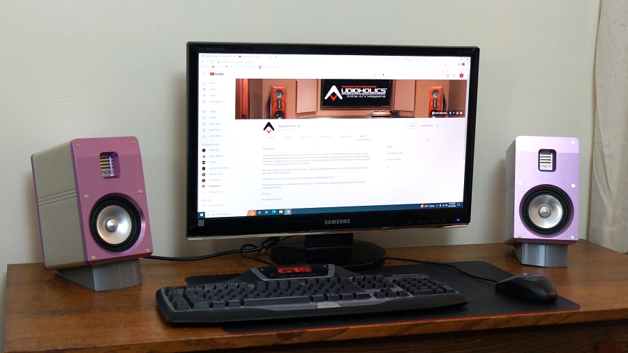

I knew very little about Mon Acoustics except that they were a high-end loudspeaker manufacturer based out of Korea, so I was a bit surprised when Audioholics editor-in-chief Gene DellaSala asked if I wanted to review a pair of their speakers. With enclosures made from aluminum, these are not your typical loudspeakers; to be honest, they are not quite like anything I have dealt with before. The metal cabinet is only one of the unusual design characteristics of their speakers, and there are a host of others that we will cover in this review of the SuperMon Mini. The Mini, as its name indicates, is a small loudspeaker designed for small rooms or desktop systems. At $2k per pair, they are geared toward those interested in luxury products and want to get the most out of a small space. They are manufactured and hand-assembled entirely in Korea. With an all-aluminum cabinet, the luxury aspect is certainly there, but what about the other elements that comprise a loudspeaker? That is what we will be examining in today’s review of the Mon Acoustics Supermon Mini...

"The SuperMon Minis are not typical stand-mount hi-fi loudspeakers. They are desktop/small space loudspeakers intended to be placed in a quarter-space acoustic environment. Therefore, the usual suite of measurements that we post is not really suited for evaluating them."
This comment from the article doesn't track for me at all. Surely a basic on-axis response in the standard presentation would be quite informative for a nearfield application. I can interpret from the horizontal polar, but it feels purposefully obscured here.
As to the product itself, there is nothing to see here. If you are looking for a small desktop speaker with aluminum construction, the Genelec 8030C is cheaper with a far more optimized waveguide and cabinet shape, plus it comes with amplification built in.

Pretty interesting that they're all metal. I've always wondered why there's not more fully aluminum speakers out there since it's not super heavy. If people are ok with 250lb subs they would be ok with 200lb+ towers and lighter monitors I imagine that are even looking at this stuff.
I'm confused how this is a high end anything other than price tag. But that said, I'd be interested to hear them. The SPL response graph looks unattractive to me regardless of the measuring process, the "V" pattern of elevated mid-bass and treble. I don't expect these to dig deep, they're just too small. I guess I'm not seeing much reason for the pseudo-isobaric design of the two woofers.

James, the biggest mistake the designers made, was not to have a grill. Those cones are very frail. They are close to foil. So without a protective grill they are going to get damaged. They won't last long on a desk. That was a very bad error.
The next thing is that I'm pretty sure the bass tuning is sub optimal. Do you know the model number of the driver they used, as Mark Audio make so many of those drivers? I would love to model it. Most of those drivers should have much better bass response than that. Tuning the cabinet at 150 Hz does not sound right to me.
I think they would have been far better off with a dome tweeter rather then that deeply set AMT tweeter.
I have a strong hunch that design could be improved a lot.
I believe that the driver is the Mark Audio CHR-90.
I don't think the lack of a grille is a big problem for most people. The people who get these speakers are not going to be placing them in an area with a lot of physical activity. These are desktop or office speakers for well-to-do folks, or maybe bedroom speakers for smaller bedrooms. They aren't likely to be used around kids.
As for the bass tuning, there are two things going on, the port loading and the isobaric system. The isobaric system seems to give it a 2nd-order roll-off, but the port seems to give it a mid-bass bump. Maybe there is room for improvement, but when you are using aluminum as an enclosure material, it becomes difficult to make the cabinet larger, and it would also be contrary to the goals of this speaker. As you know, most commercial loudspeakers would have improved performance with a larger enclosure, but manufacturers have to draw the line somewhere in terms of size or else no one would buy the speaker.

These speakers seem very similar to the Paradigm Signature S1, both being all-Aluminum construction. But the S1 came with Paradigm’s highly regarded Beryllium tweeters. How do you think the S1 would compare with the Mon?
I don't really know how it would compare. Paradigm usually gives their tweeters a bit of a bump, so I would speculate that the Paradigm has a more forward sound, and the Minis would sound a lot warmer in comparison.
Thanks James. I will take a close look later. However I looked at the documents for that driver, and the response you measured is virtually identical to the closed box response, including the ripple at 150 Hz, and the second order roll off. I get the feeling this is a great amateur hour achievement.
