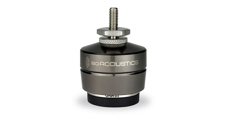

So how do we reconcile myth number ten with those thousand dollar IsoAcoustics Gaia isolators?
10. Myth: “Acoustic isolation can very often improve the sound."
Truth: Competently designed loudspeakers don't transmit much mechanical energy through their enclosures and are not usually enough to audibly vibrate other objects through mechanical transmission.
I was thinking the exact same thing when I read that part of the article...
