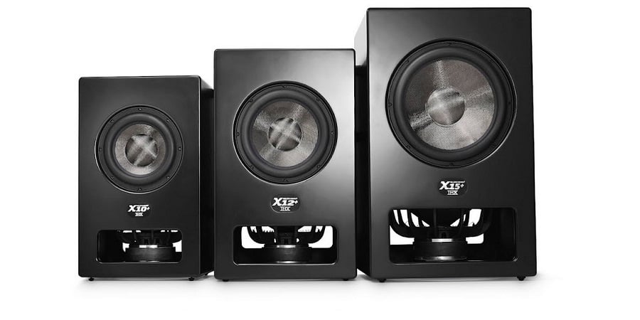

Looking at the pictures, in each cabinet the two drivers are at 90° from each other. That doesn't look like a push-pull design to me.
Why do you think that isn't a push-pull arrangement?
A real push-pull arrangement is where the drivers are disposed 180° apart. This means, either the two cones or the magnets are facing each other:

Either design uses box pressure to push and pull right? Do physics care how they're oriented?
The drivers are connected out of phase. When one pushes the other one pulls. It's the amplifier that controls most of the movement, not the box air pressure.
Yeah I know they're wired out of phase. It's a sealed cab tho right? So the changing box pressure would still be relevant for the push pull, right? In my head they'd still be doing that at a 90° angle, but I fully admit I don't know. I'm asking to learn.
Here is more info on isobaric speaker enclosures. By the way, an isobaric arrangement allow you to build a cabinet half the size of the usual ported box for the same low frequency performance, but at the cost of using two drivers. The other advantage is that two drivers can handle double the power:

The changing box air pressure has a slight influence on the drivers displacement as happens for a single driver in a sealed box. That is why I have always preferred ported designs which have lower distortion in part because of a more linear cone displacement at higher SPL.
As for the M & K sub, it seems to have a similar design to the newer models.

@Verdinut do you know anyone selling a push-pull in a dual opposed design? I can't think of anyone doing that.
