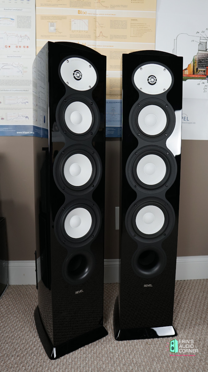

The Revel Performa F226Be is a “compact” floorstanding 3-way loudspeaker from Revel’s PerformaBe lineup featuring (2) 6.5-inch midwoofers, a single 5.25-inch midrange and a 1-inch Beryllium dome tweeter on a waveguide. This speaker retails for $3500 USD/each ($7k USD/pair).

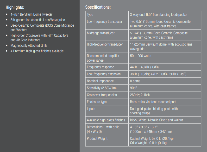

I have taken the liberty of copy/pasting specifications directly from Revel’s website below:

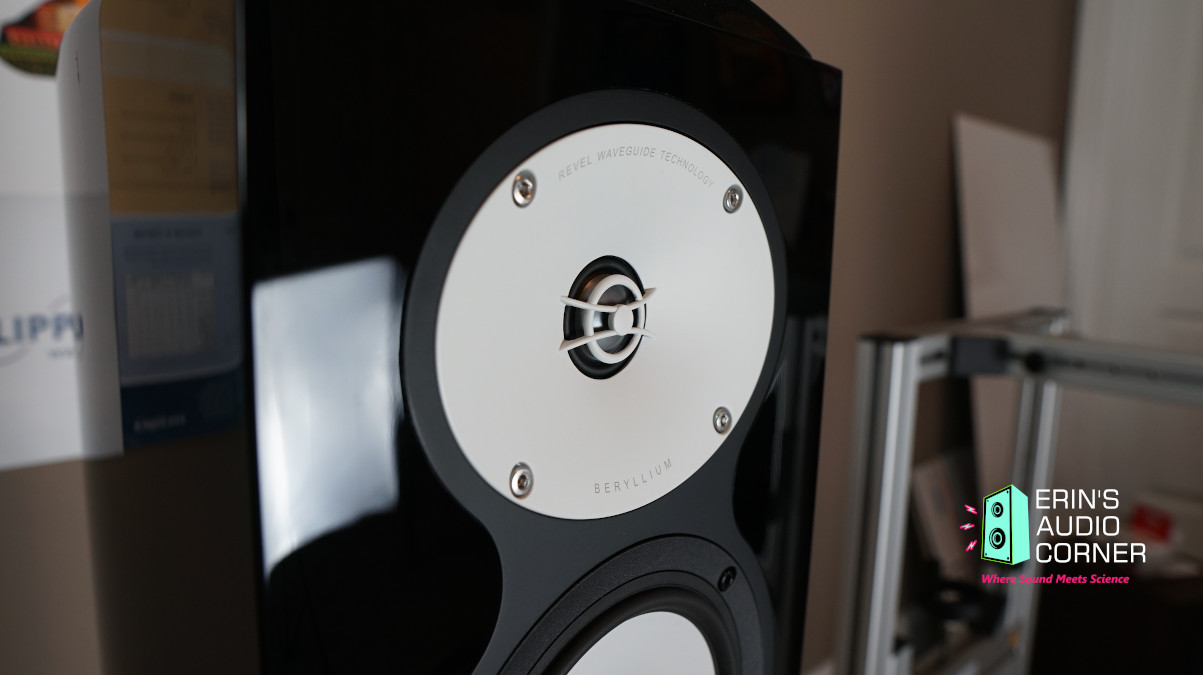

The 1-inch Beryllium dome tweeter features an acoustic lens to help control dispersion while also serving to protect the tweeter from damage (this tweeter being made of Beryllium, a needed feature). The relatively shallow waveguide provides directivity control designed to match the response of the midrange at the crossover to create a smooth “hand off” between drivers both horizontally and vertically.

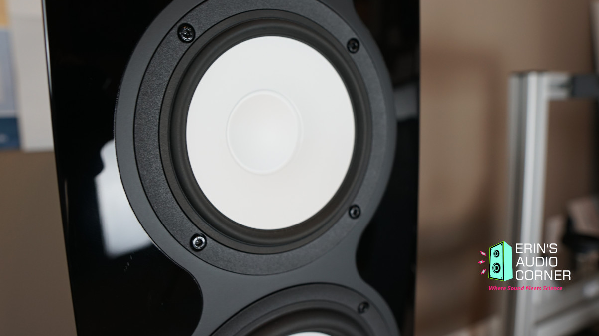

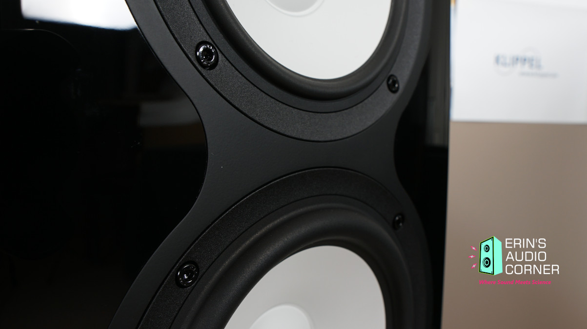

The 5.25-inch midrange features a different surround than that of the midwoofers. I find this interesting because many manufacturers make essentially the same drive units in various sizes for different implementations. While the T/S specs often reflect the intended use (such as a higher or lower Fs), the look of the drive units is often identical; just scaled in size. This midrange drive unit, however, features a distinctly different surround than that of the midwoofers. While I thought this was to reduce diffraction I hadn’t considered the obvious reason which HARMAN told me was the basis: The reason is not for directivity or diffraction. Rather, a smaller surround radius with a correspondingly larger diameter diaphragm reduces moving mass, plus larger cone area equals higher efficiency, which reduces compression. So, senstivity. Makes sense.

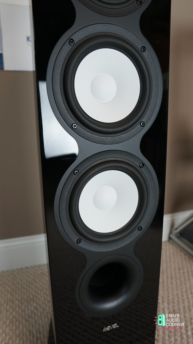

5.25-inch midrange on top. 6.5-inch midwoofer on bottom. Again, notice the different surrounds.
Dual 6.5-inch midwoofers and front-mounted port.

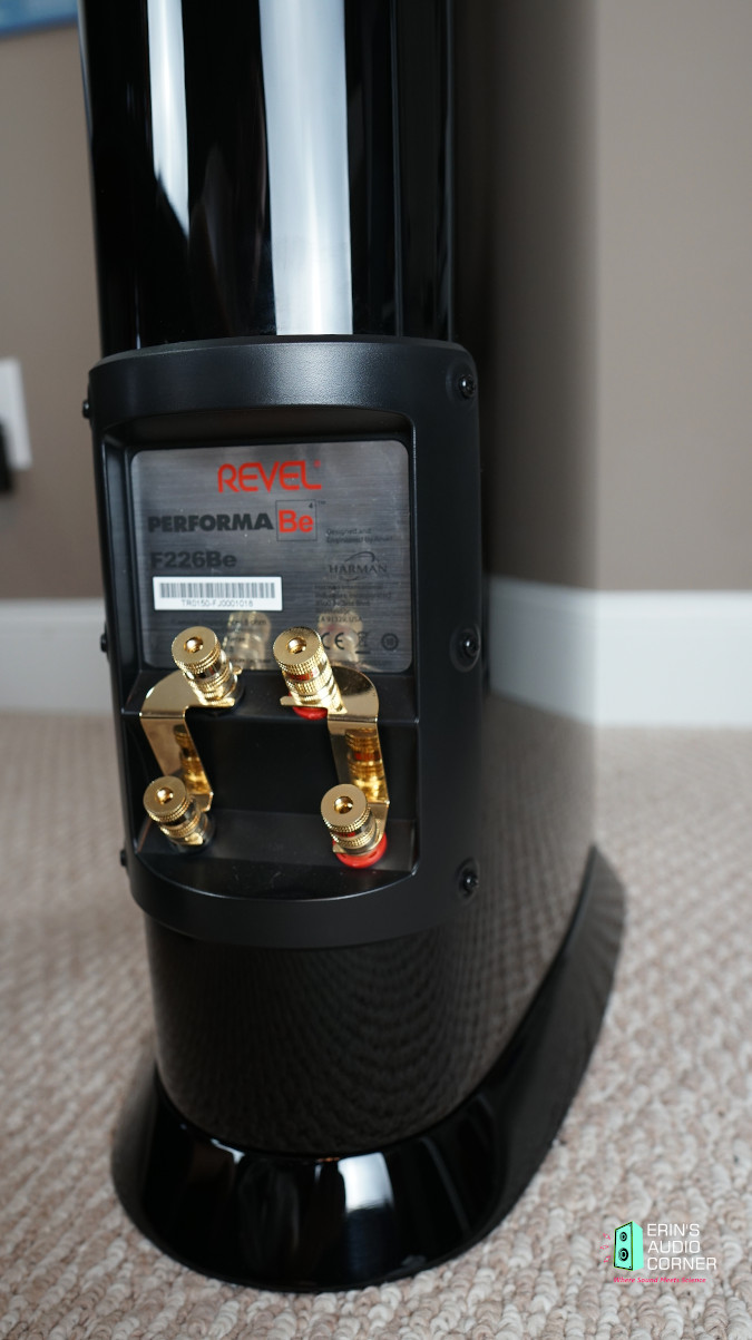

Rear speaker connections, implementing 5-way binding posts with the option to bi-amp or bi-wire the speakers if so desired.

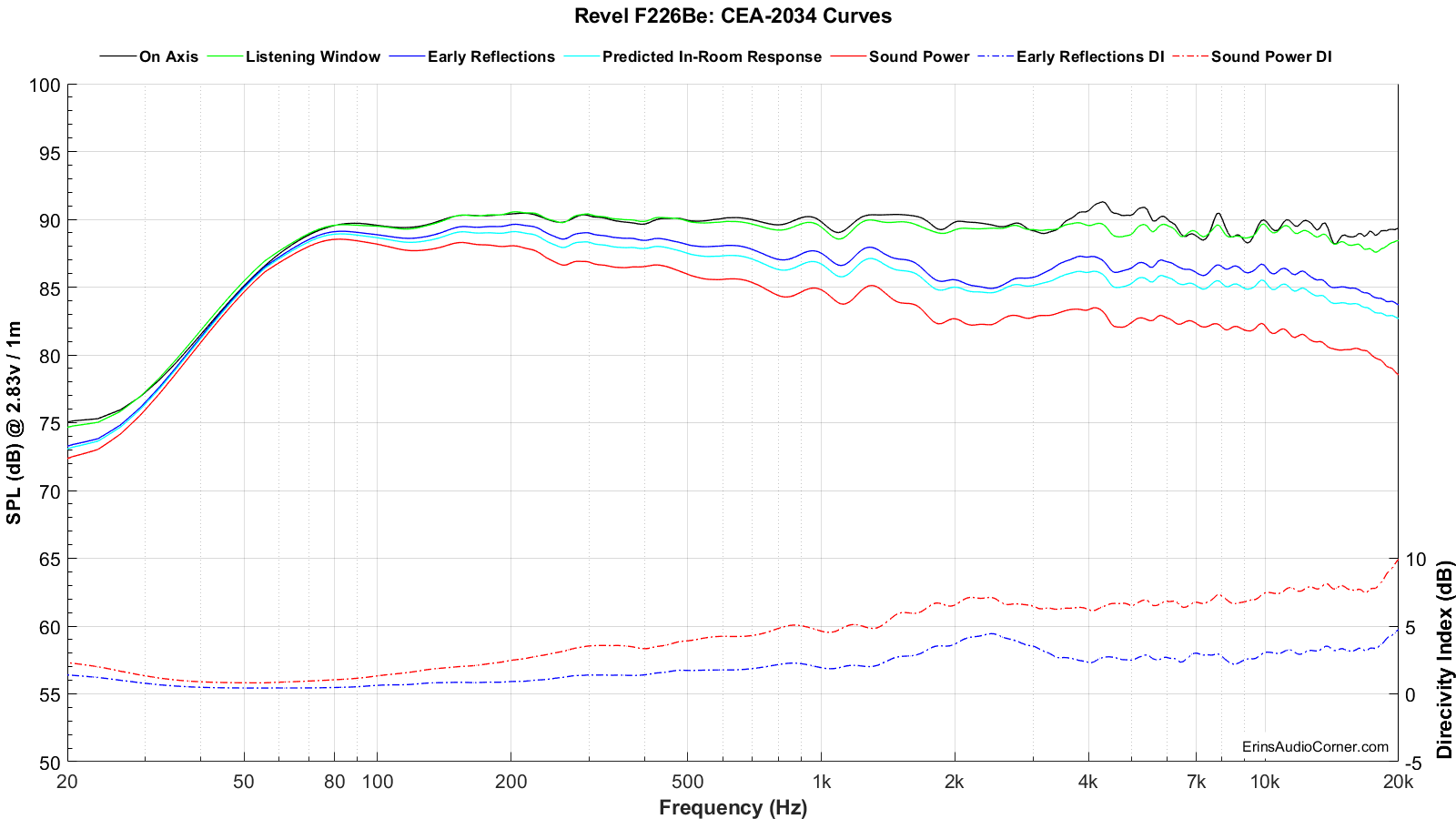

CEA-2034 (aka: Spinorama):
The following set of data is populated via 360-degree, 10° stepped, “spins” from vertical and horizontal planes resulting in 70 unique measurements. Thus, this is sometimes referred to as “Spinorama” data. Audioholics has a great writeup on what these data mean (link here) and there is no sense in me trying to re-invent the wheel so I will reference you to them for further discussion. However, I will explain these curves lightly and provide my own spin on what they mean (pun totally intended). Sausalito Audio also has a good write-up on these curves here. Furthermore, you can find discussion in Dr. Floyd Toole’s book “Sound Reproduction”. And, finally, here is a great video of Dr. Toole discussing the use of measurements to quantify in-room performance.
In short, the CEA-2034 graphic below takes all the response measurements (horizontal and vertical) and applies weighting and averaging to sub-sets and can help provide an (accurate) prediction of the response in a typical room. If there is a single set of data to use in your purchase decision, this is probably it.
Alternatively, click this arrow, if you want my quick take on what these curves mean without going to another site.
Below is a breakout of the typical room’s Early Reflections contributors (floor bounce, ceiling, rear wall, front wall and side wall reflections). From this you can determine how much absorption you need and where to place it to help remedy strong dips from the reflection(s). In this case, the listening room would benefit from having at least a carpeted floor and, if willing to do so, acoustic absorption on the ceiling between the listener and the speakers.
And below is the Predicted In-Room response compared to a general target curve equaling -1dB/octave.
You may ask just how useful the above prediction is. Well, I’d be remiss for not delving in to that a little bit here. Please see my Analysis section below for discussion on this.

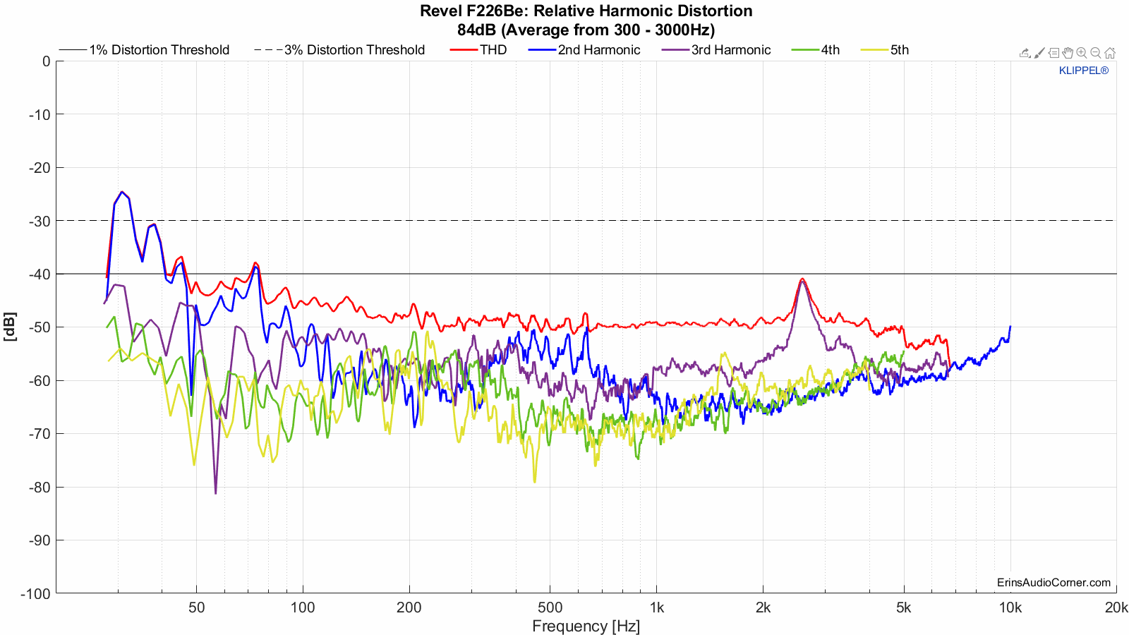

Harmonic Distortion:
Measurements were conducted at 2 meters ground plane using Klippel’s TRF module. Multiple output levels were tested to provide the trend of distortion component profiles and to provide a comparison against other drive units I have tested. The SPL provided is relative to 1 meter distance, averaged in the noted bandpass region.

  • At 90dB at 1 meter (which is equivalent to 78dB at 4 meters) the F226Be distortion levels are below 1% above 50Hz.
  • At 104dB at 1 meter (which is equivalent to 92dB at 4 meters), the low frequency distortion increases but is still respectably low between 1-3% THD from 50Hz to 200Hz. Note: The F226Be is also the only speaker I have tested at this output level so far.
  • The midrange distortion is remarkably low at approximately 0.30% THD at 104dB at 1 meter. The lowest I have tested so far.

  • The spinorama data indicates the listening window is quite linear and, in fact, smoother in the 4-6kHz region than the on-axis response. I’m not quite sure what causes the (mild) bump in response on-axis in this region. Possibly some mild horn loading of the tweeter from the waveguide? The other possibility is diffraction but the nearfield data still shows the mild bump which indicates it is based on the drive unit itself, rather than an effect of the cabinet. However, the spinorama data shows no signs of resonance here so I would not concern myself too much with this.
  • There appears to be a resonance around 250Hz as evidenced by the dip in all the spinorama data. I intentionally listened for this later but didn’t find any apparent audible issues.
  • The directivity index graphs (dashed lines) also show a very wide directivity speaker. Since we know the horizontal and vertical dispersion is wide, we can deduce that this will help create a larger sense of space in the soundstage (height, width, and depth).
  • The early reflection data and directivity index shows a mild directivity mismatch right around 2.5kHz. Judging by the “Vertical Spectrogram Normalized to On-Axis Response” plot, this shift in directivity appears to be due to the off-axis vertical response with respect to the on-axis vertical response.

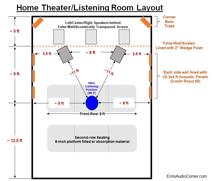

I listen to speakers in two different rooms: my home theater room and my living room. I have provided a layout of the home theater below. And below that is a picture of the speakers set up in my living room. This gives you an idea of the actual environments these were auditioned in.
Home Theater layout:
Per the illustration, I built a false wall and used an acoustically transparent screen with speakers behind it. The wall is only 2x4's; no panels of wood or anything. Just a skeleton of a wall to give me something to attach the screen and acoustic treatment to. There is 2-inch wedge foam affixed to the 2x4 studs and between the false wall and back of the room are the front speakers (L/C/R & 18-inch subwoofers).

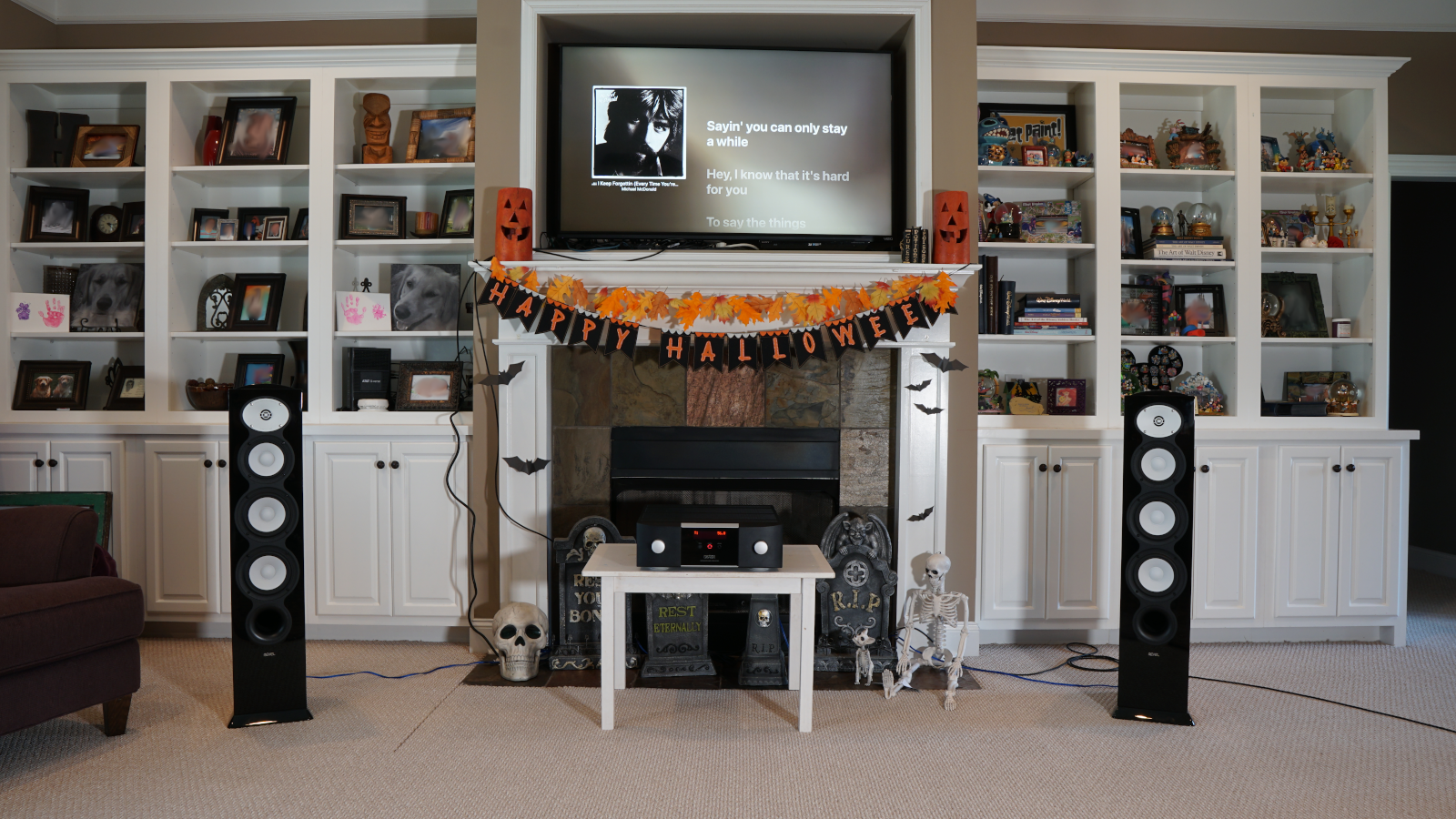

Living Room setup:
Happy Halloween!!!!

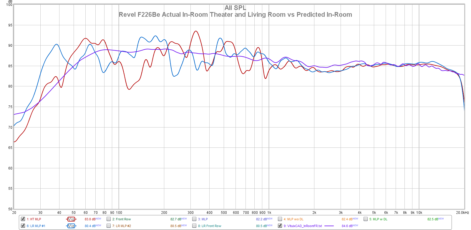

Below is the measured in-room response at the main listening position (MLP) of my Home Theater (HT) in red and my Living Room (LR) in blue both compared against the predicted in-room response (purple). These were taken via the moving microphone average, covering the space of about 1 cubic foot in the MLP. The measurements/prediction below do not have EQ applied.
You can see the prediction follows pretty reasonably to what is measured in the seated position in both rooms, aside from the typical lower frequency modal issues caused by the rooms themselves. Two completely different listening setups yielded a similar response that both match the predicted in-room response borne from the spinorama data. This proves that the anechoic data and means to provide a predicted room response result in a very accurate prediction.
